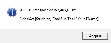

Ok, i dont know if anyone else is suffering this annoying error, i made a serch and culdnt find any post related to it.
My problem is very time i hit the TPOSE MESH button, when zbrush starts going subtool by sub tool it suddenly stops and this error message appears:
After that nothing happens and the tpose mesh is never created, then i cant use transpose master again, unless i restart zbrush and the error keeps hapening every time i use it, some times it works, and ive not find a reason of why it works with some tools and not with others. please help, this is extremely annoying :confused:

Can you both check two things for the models you are using with Transpose Master:
  1. That there are no duplicate SubTool names.
  2. That the names have no characters other than alphanumeric (A-Z, 0-9) and hyphens (-). Especially check that there are no slashes (/ or ).
Let me know if that solves it. If after checking/correcting these you still find the error occurring can you share the model with me? This error is proving difficult to pin down.
Thanks,
I checked all of my names. 2 subtools had the same name, ie. “subtool_2” and “subtool_2_2”. I went through all the subtools and renamed them differently. My transpose master is now working. If it gives me an error again I’ll update you. Thanks Marcus!
