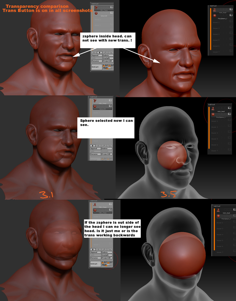

Anyone know how to get the transparency back to the way it was in 3.1? Some genius decided to reverse it in the 3.5 release. Unlike every other 3d app. it now make everything transparent except the mesh your working on.

[Trans comparison.jpg]
If you need to see the shape of a reference object behind or inside the object you’re sculpting, then Preferences -> Draw -> Back Opacity and turn it up to around 0.5.
If you are sculpting a reference image, put the image plane object in front of the object to be sculpted (or maybe outside it, using an image plane cube. Turn Preferences -> Draw -> Ghost Clear Transparency off.
With Ghost Clear Transparency on, Front and Back transparency are independently adjustable.

Kerwin, Thanks but I already played with that. You still can not duplicate the effect that 3.1 had. The selected subtool should be trans not the other subtools. Open both versions and try it. completely different.
I’m thinking pixologic put that goofy ghost mode in just to show of the new zsphere rigging. :rolleyes:
Yep, it’s different. Better open a support ticket since this is the third thread with the same complaint in 3 days. I know of no way to reproduce ZB 3.1 behavior.

This is the most awkward bug (or feature, in case they’ve lost their minds) that I’ve run across in 3.5 so far. I was looking forward to finally use ref planes in ZB, but this makes them practically useless. Placing the ref in front works to some extent, but if you do that you can only see the selected sub tool through it, while everything else is invisible. You can’t control opacity of the plane either.
The model opacity slider in the old image plane plugin seems to work though, so you can still place the refs on canvas as before.
