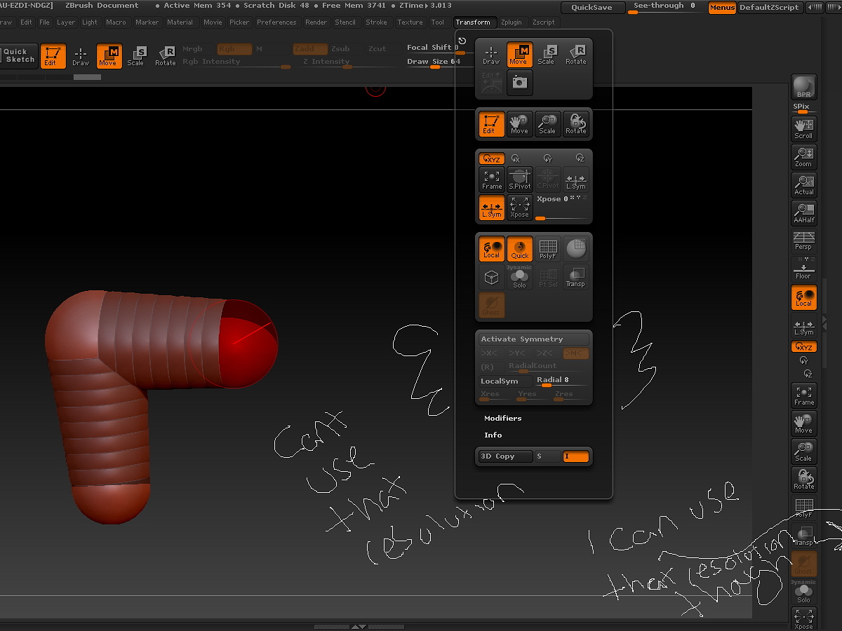

Okay, http://imageshack.us/f/802/mdv1.png/
As you can see, I don’t have any control over the Resolution of the individual axis. If I change the I-res value, it changes the whole value for everything.
In the picture, I made an adaptive skin, and I’ve tried it without making an adaptive skin.
You have to be in ‘Draw’ mode to activate those. You are not in ‘Draw’ mode. You have the ‘Move’ transform active. So ‘Use Classic Skinning’ has to be on in ‘Tool > Adaptive Skin’ and you have to be in ‘Draw’ mode (button beside ‘Edit’ button)

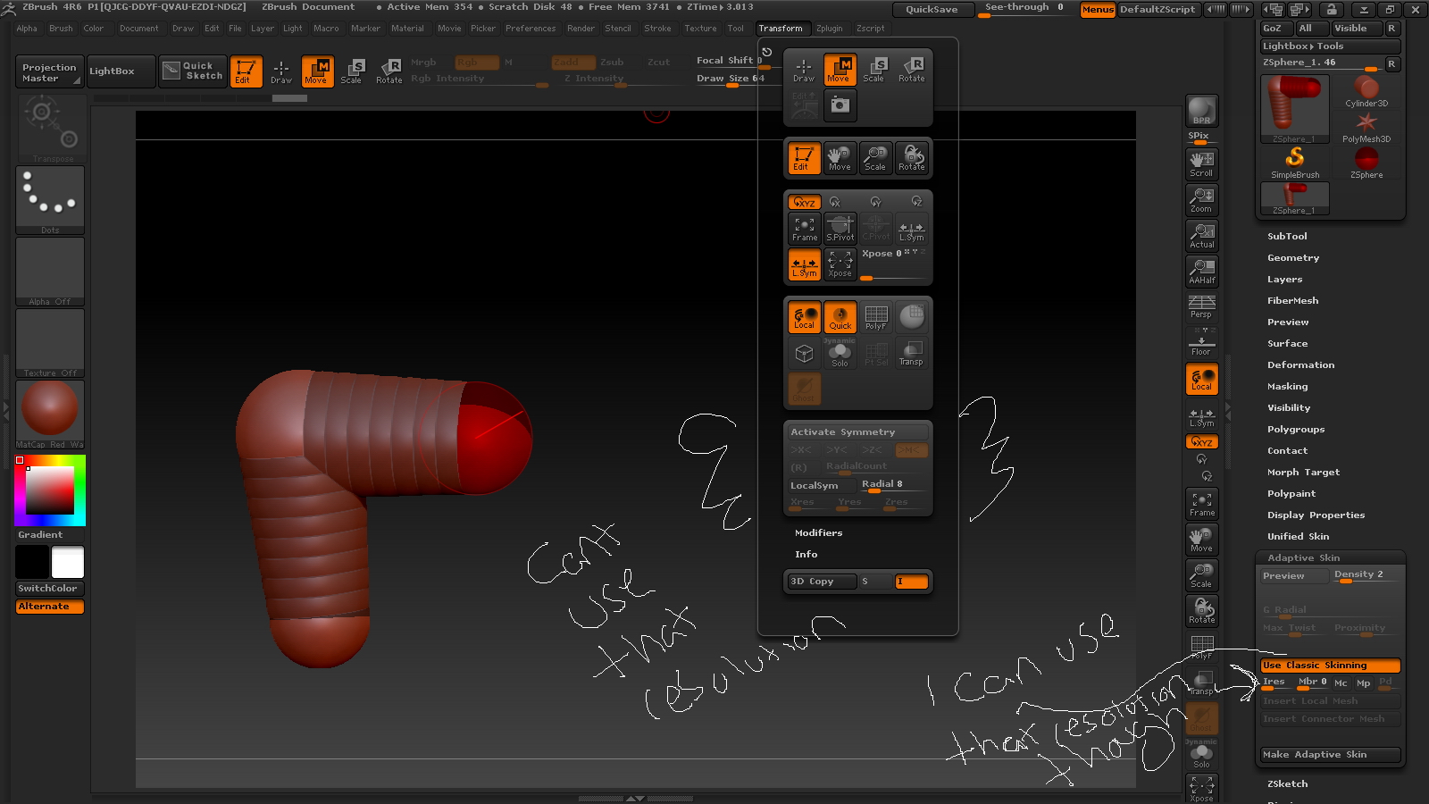

I am going to post your image here so people finding this thread later won’t be following a dead link.

Ah thanks! It works now, lots of parameters to get it to work lol. I guess I adjusted it too much before selecting the Draw brush so it didn’t pop up.
