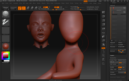

Is there a way to transfer information from one sculpt to another?
I sculpted this head from a head base mesh , and I want to put the sculpted head onto the other character with the body. How would I go about doing this? Or do I have to sculpt the face over again on the head with the body?
The easiest way is probably with the Zproject Brush. Here’s the basic process:
http://www.pixologic.com/docs/index.php/Tutorial:ZProject_and_SubTools
You’ve complicated matters somewhat by posing the mesh first though, so the head and its target mesh are no longer facing the same worldspace orientation. Once the original head subtool is appended and ghosted with the transp command, you’ll have to “eyeball” it into the correct scale/orientation as close as possible with the transpose tools first.
Thank you! That’s exactly what I wanted to learn.
