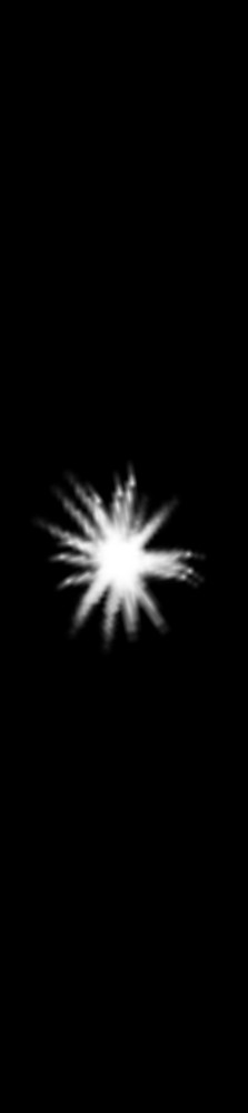

Using your 2d app, paste the alpha you want to use on an elongated background. ZBrush 4 supports non-square alpha’s. The elongation has to be vertically like the sample below. Then just use the Roll function in the Stroke menu with a setting of 1 for Roll Dist.
thanks very much, didn’t know it recognizes non-square proportions, always thought the alpha would automatically stretch no matter what to a square frame.
