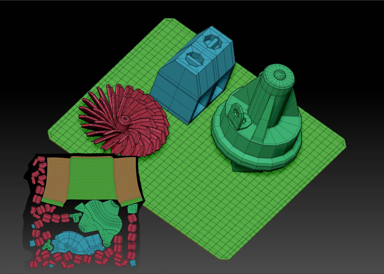

Also posted, is a simple plane, with a few mesh-insert brushes. 12,227 polys. I can lose polys on the plane… but the rest?
How do I get these details into a game? What sort of poly-count can I get away with for static objects?

For the 2nd image, those parts (minus the plane of course) are within game res. Again it comes down to the scale of the object in game, but those meshes dont look too dense. You would definitely remove all those creasing loops near the bevels and borders since they ramp up the poly count without contributing much to the overall shape.

Thankyou for the response. Just one more detail to the question… on the second image, those are zb4 insertmesh presets, Let’s say I want to add those to the Demosoilder, or other similar inserts. It would be an up-close static object. Just merge the objects after uv-mapping, b4 I GoZ to maya, and then cryexport after defineing textures/shaders etc.
The goal is, to make some sections of realistic “tech” tunnels or hallways. Think submarine interior, or spacecraft. The outer hull will also be seen.
The point is, I want to make some prefab sections that can be snapped together and reconfigured, with details like floor grates, and conduit, floor lights etc. underneath.
My issue has been on re-topo, to keep the objects that cant be projected.
As I describe this, I think I’m getting my own answer… create my low poly details, uvmap them, merge subtools and export. I’ll repost my attempt, later in the week.
