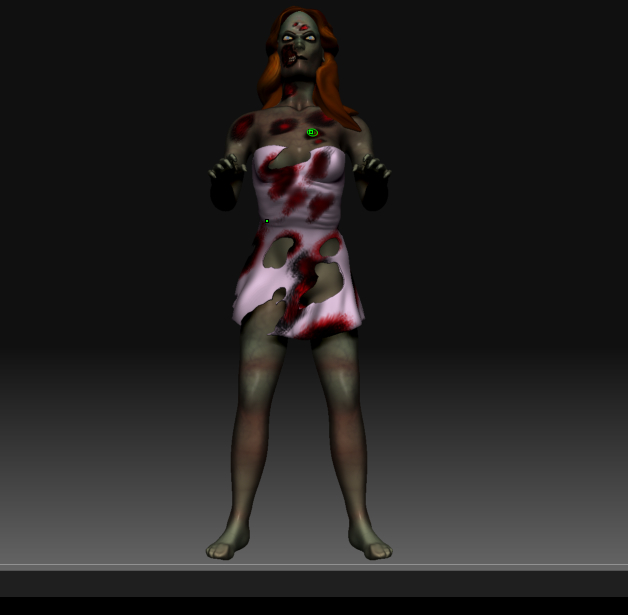

this is the character… i haven’t posed her yet cuz i am scared to lose the symmetry… if you see the 2 green dots… that’s where zbrush thinks symmetry is, but if i use normal active symmetry and not posable it’s fine zombie capture.jpg
Try Smart Resym, then see if your symmetry line works better. You may have just inadvertently lost symmetry at some point.
