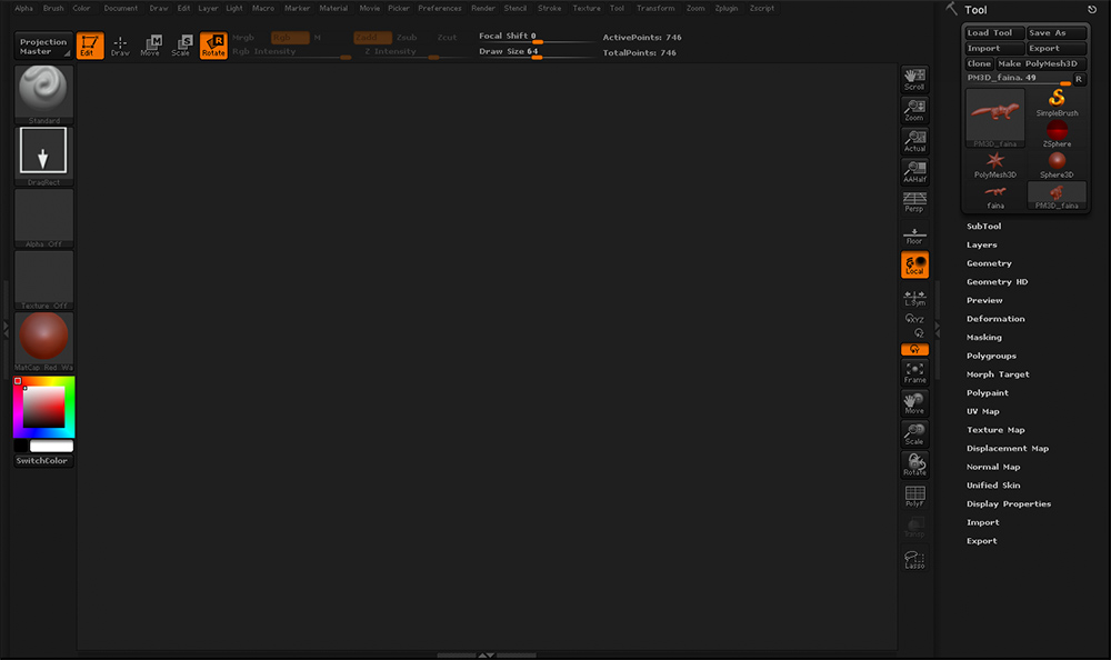

I can’t find a topology tool (or a rigging one, for that matter) anywhere. All of my searches have indicated that they should be under tool, but they’re not.
I’m using ZBrushOSX 3.12… on a mac, obviously.
Does anyone know what’s going on?
The interface i do have is attached.
Check out the online documentation in my signature. It has instructions for how to use the retopology feature.
Rigging and Topology start with zspheres. You start with a zsphere first and then bind your mesh to the zsphere. The rigging, topology, and projection subpallets will appear auto-magically when you start with a Zsphere. (just like the “Initialize” sub pallet only appears when you’re using primitives.
