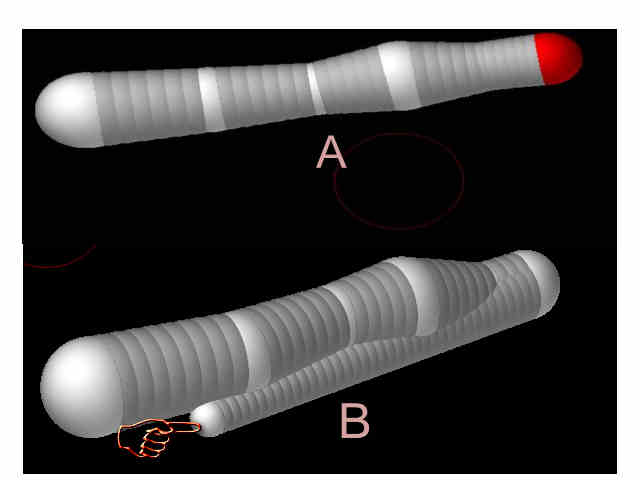

dear Aurick. no, not that.
Have a look at the shown upper A construction. You don’t see anything.
but inside there is another construction.
It is shown by finger below, B.
The task is to be able to see B inside A.
Only final adaptive skin or pressing “a” letter of the keyboard, making the final mesh,then using other soft so that to quickly see the inner mesh (result of B), inside outer A.

Image about seeing inner spheres.
