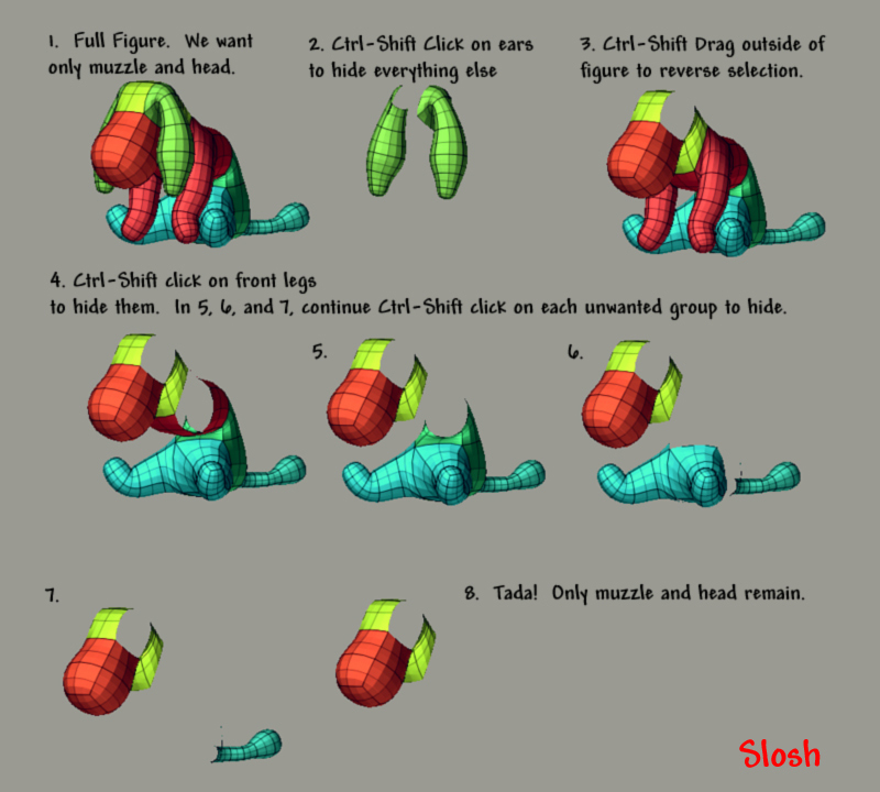

Hi everyone. This is probably old news to some of you, but I stumbled upon this technique while messing around with an old model of mine. I’ve seen zscripts and tutorials by other artists that demonstrate hiding unwanted polygroups and they usually show the ctrl-shift drag rectangle to hide unwanted areas. Seemed a bit time consuming and unreliable on complex objects to me. So here is what I came up with. I tried labeling the picture directly to show the steps.

Or you could ctrl + shift + left click on the head to show only the head and then ctrl + shift + left click and drag to inverse the display and then ctrl + shift + left click on the mussel. And then ctrl+shift left click and drag to inverse the display
Half as many steps :slight_smile:
Thats good or you could save yourself the frustration and redundancy and just ctrl shift click the line where the red and yellow meet for the muzzle or where any two poly groups meet this should give you the exact selection you need i hope this helps figured i would tell you since its something that can be faster in some cases!!
one step only and faster then the previous try it it works great!!

Also, I`d like to add that you can control the polygroups, assign them where you want so this kind of selection will go easier and in the exact areas you need.

It does have to be a SD resolution that’s higher than one to work.

-E- you are right! That would be several steps shorter.
AVTPro, also correct. I didn’t try it at level 1, but you are right.

Troy - do you have to be in point selection mode for that to work? If so, it would be much easier indeed. But, if you were lazy like myself, you would either not feel like switching to point mode, or you may also forget to switch back. I’m glad to see a quicker alternative, so I thank you.
Ryan - I would be happy to post it there. I’m not familiar with the site (although I checked it out right before I typed this response and registered), so I don’t know where I would submit it. Any suggestions?
No you dont have to be in point selection mode for it to work slosh!! Im glad it helped and its good to see you around again and your welcome!!

Right, so there is the eight step way of selecting and there is the normal single click method. Unless I’m missing something here.
just different ways of doing the same thing, dogbone. More than one way to skin a cat, as they say. As I said when I posted this, it’s probably old news and not something everyone is interested in. If you figured out the one click thing, then go ahead and use it. I fumbled around trying to hide polys til I was frustrated. This just was a happy accident for me and I wanted to share it.
