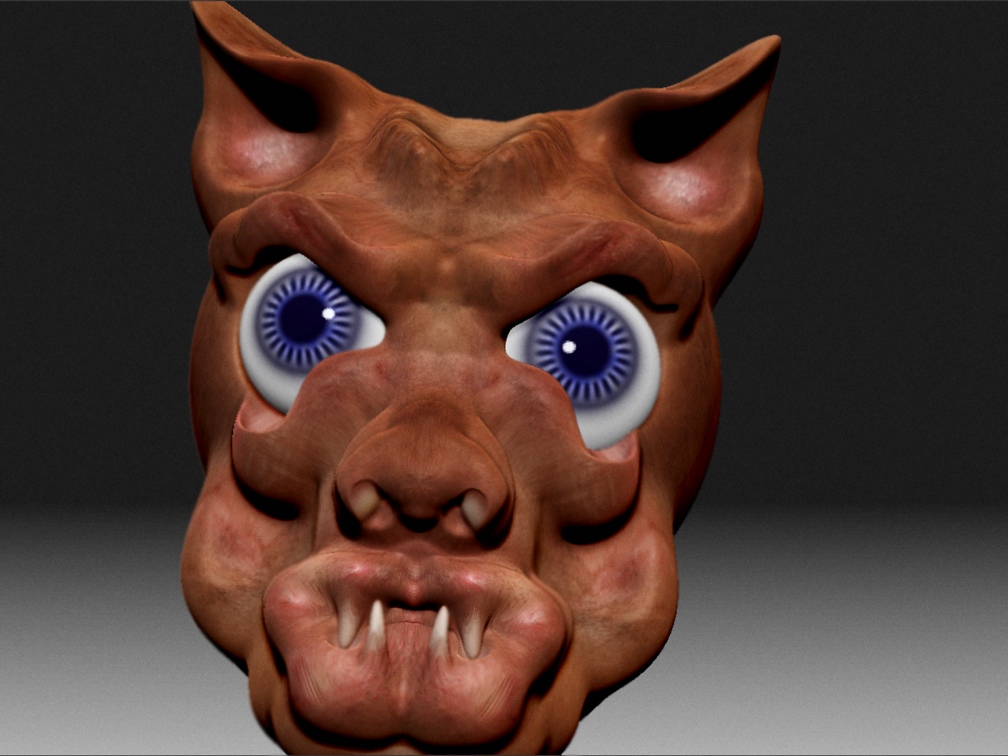

Hi guys, this is my third go with Zbrush. I want to make the body with Zspheres but am having problems with polypaint, Zbrush crashes when I press the “new from polypaint button”, does this not work with Zspheres? DOG .jpg

After making a model with Zspheres, I then paint/texture it, when that is finished I click the ‘new from polypaint button’ (as I did when texturing the dog model (picture above) but with Zspheres it always gives an unexpected result such as turning the model black or changing the painting/textures or just crashing!
