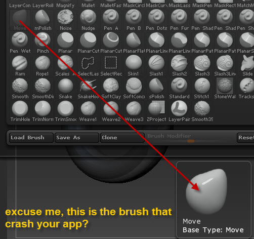

excuse me:
thanks in advance
That is indeed the brush… the simple old move tool.
I will try copying my 3.5r3 one.
