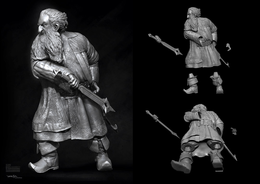

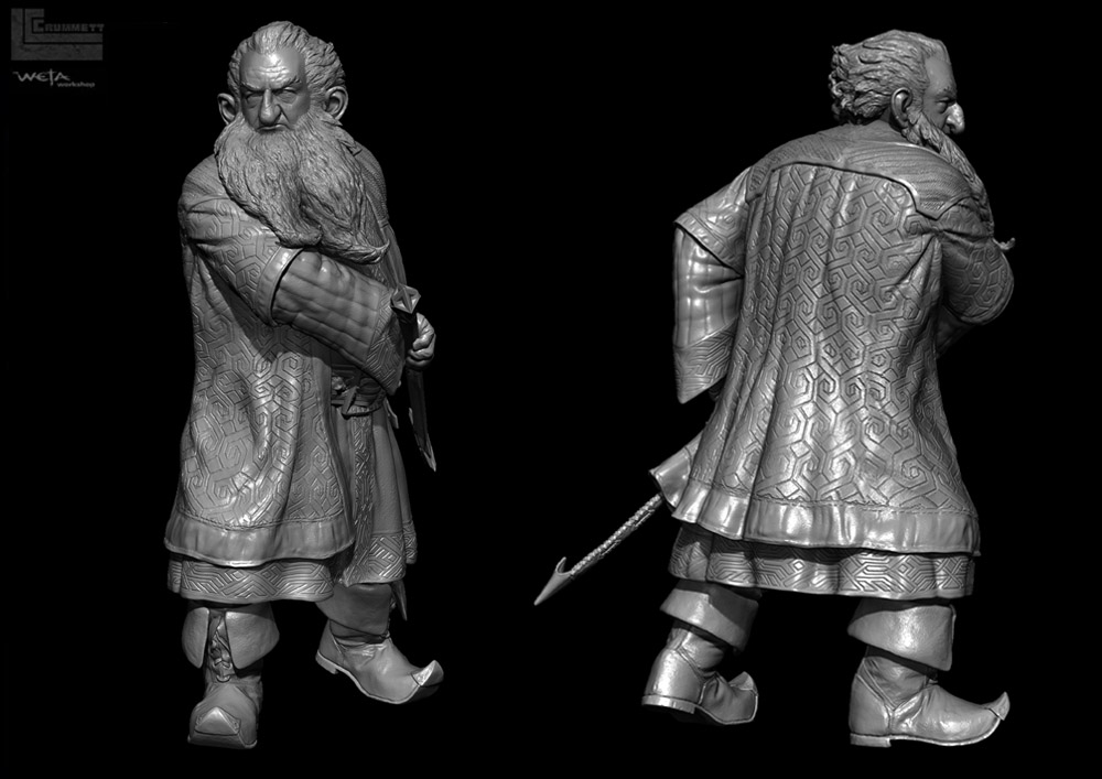

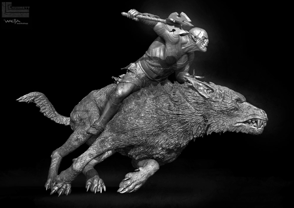

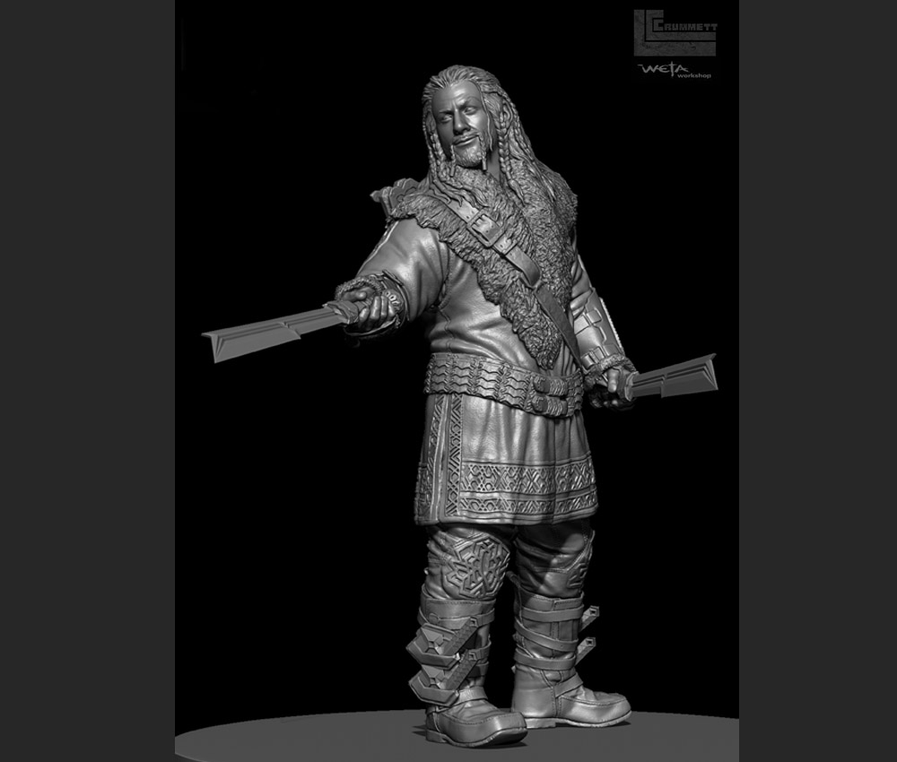

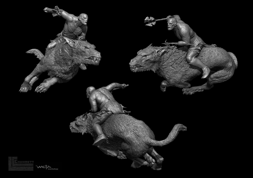

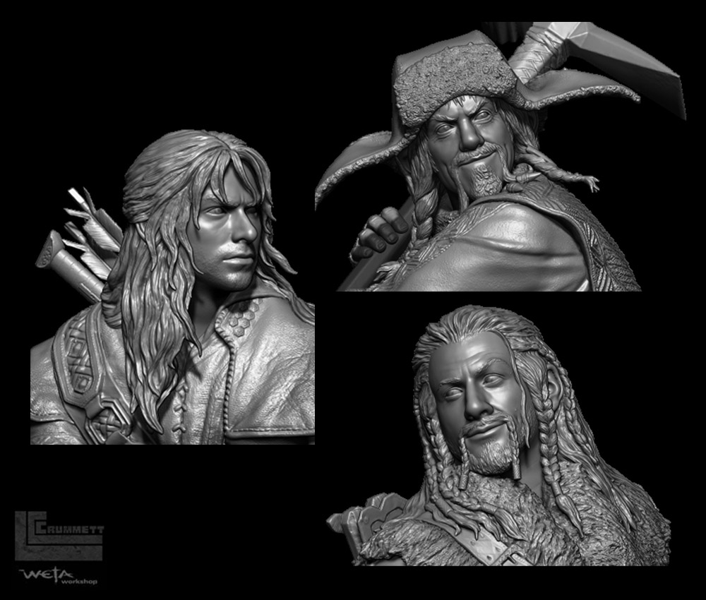

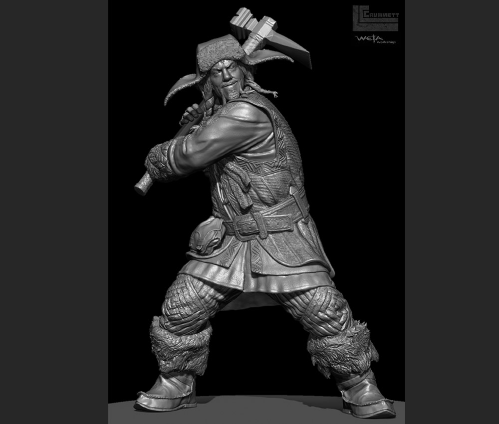

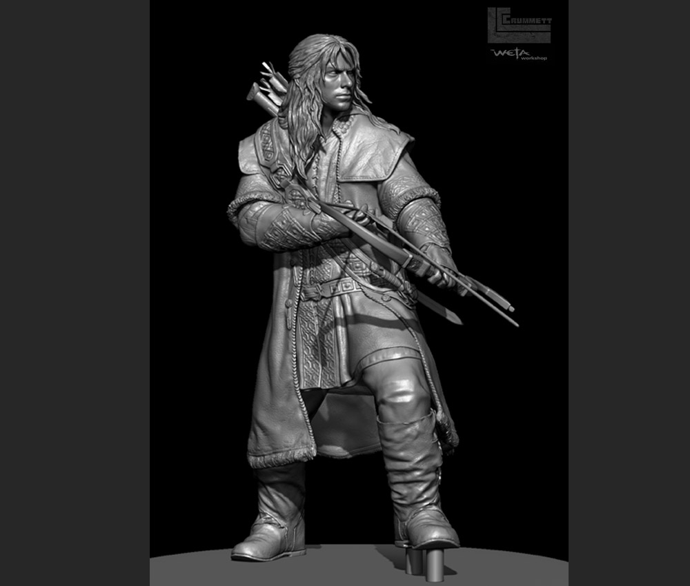

Hi there, I’m a digital sculptor and designer at Weta Workshop. Most of my involvement on The Hobbit was in the Collectible line released. I have sculpted several of the Dwarves as well as Azog on the Warg for the Weta Hobbit Collectibles range using Z-brush.
It was an interesting process to navigate, and it evolved as we sculpted more figures in the range. After a piece had been fully sculpted, we then cut the figure into pieces and inserted a peg and hole so that when the pieces were 3D printed, they would be ready to fit together snugly. I’ve attached a couple of pics of that process as well as the finished Z-brush pieces. After they’re 3D printed, we moulded and cast the pieces in hard plasticine and sculptors cut some of the detail back in that was lost in the printing process. 3D printing is getting better and better to where we’re no longer having to do this part of the process, and can take the 3D print directly into paint, which is awesome!
Here’ is a link to the Weta Website where you can see the finished, painted collectibles:
http://www.wetanz.com/hobbit-auj/
Cheers guys, I hope you enjoy!
And a few more…

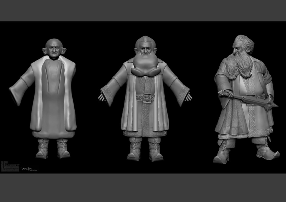

to answer a couple questions; Yes I do use perspective while sculpting collectibles, though I keep it on a low level like 35 and toggle back and forth often. And No these weren’t used as assets in the actual films, but were sculpted specifically for collectibles. We began by working on several pose options for each. I may actually work up a video for the collectibles process, stay tuned for more info on that!

RasmusW, yes we did use scan data for the faces. Depending on the character, some of the scans had varying levels of detail and they were always in a blank expression and had no hair. Most of them had lost detail, so we had to sculpt it back in and put it into an expression and sculpt the beard. The scans were incredibly helpful though, as in collectibles the buyers are always extremely concerned about the likeness, so at least all the major forms are in place. The rest of the body, clothes and details are sculpted with exception to some of the weapons.
On average, a dwarf would take around 150-200 hours to sculpt, depending on costume, pose, and feedback from clients. Cheers!
