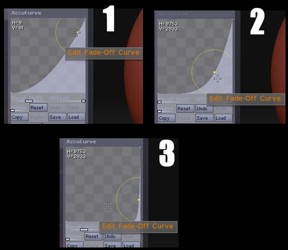

Update on the artifacts with flat surfaces bug. It occurs with both matcap and regular materials.
- Load StandardSet Brush. This brush doesn’t save out an Edit Curve.
- Load a brush I made … Edit Curve is saved in the Source folder and loads properly.
- Load StandardSet Brush again and the Edit Curve seems to have multiplied or sommat (remember, there is no Edit Curve saved with this brush).
None of the brushes that ship with ZB3 have separately saved Edit curves, so I’m not surprised this wasn’t spotted during testing. But if you make a brush with an Edit curve then you’ll get bizarre effects when switching between brushes with and without curves saved. The Smooth Curve doesn’t appear to do this.
[attach=60358]EditSmoothOdd.jpg[/attach]
I can’t reproduce this behaviour as you describe it. If you load a brush with a saved curve then load a brush which has no saved curve then the curve will remain as it was for the brush-with-curve. That’s what I get - I checked it by loading the curve separately. There’s nothing in the code for the default brush set that goes anywhere near the curves so I can’t see how they can be affected.
What some of the default brushes do is adjust Focal Shift, and that would account for the behaviour you describe. If that’s the case, then they’ll be adjusting the previously loaded curve.
You’ve certainly raised an important point, not least because ‘Reset’ for curves does not restore the default state. The best advice is to save all brushes with curves and use only those, or don’t save with curves and load in separately.
[Edit: I’ve just noticed how the Focal Shift changes in your pics!]

Thanks … yes, we’ve been looking at ‘Reset All’ brushes in the current Newbie Challenge.
Thanks for your explanation … it makes sense now. I hadn’t appreciated the relationship between the Focal Shift in the Brushes > Edit Curve graph and the slider in the main toolbar. They’re identical twins.
