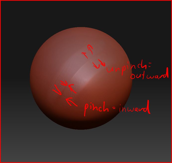

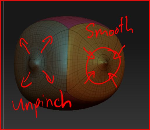

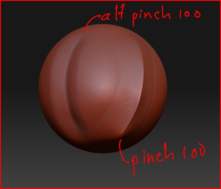

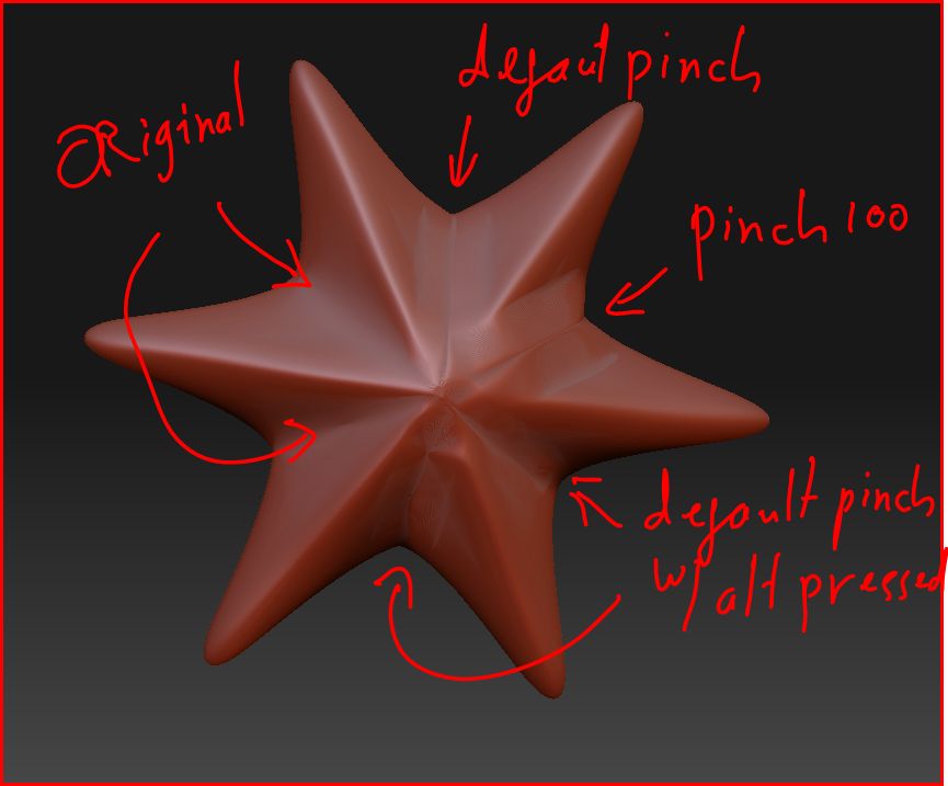

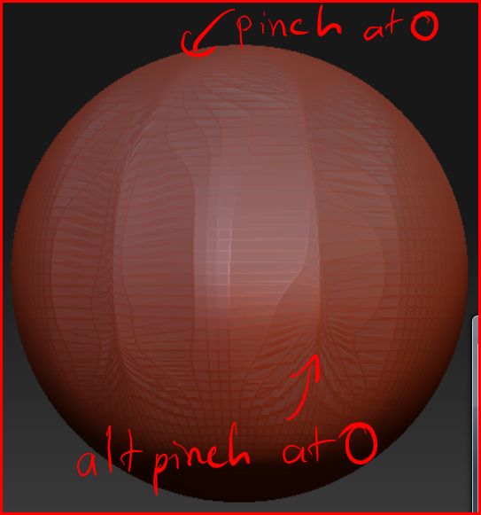

Anyway, unpinch don’t work in Z3.
In Z2, if you pinch vs unpinch (that is pinch with alt pressed):
feureau, the pinchvalue is just a offset
im not sure but i think if you use the pinchtool with a 0 value you can pinch and unpinch
instead of unpinching you could just use the smooth brush :>

Well, the value is just an offset like in flatten etc. And alt-pinch at zero is still pinching at zero offset.
Thanks for the reply, anyway! :wink:

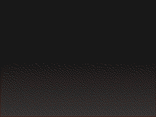

Just got ZB3.1-- had played with ZB2 quite a bit, and immediately spotted a difference that I don’t understand. Using ZB3.1 for Windows, just downloaded and activated (8/14/08). A dual-core P4 desktop, just upgraded to 2.5G RAM. I plan on installing it on my laptop as well but haven’t got to that yet (need to make some room) so I don’t know if it’s particular to the computer or if it’s a problem everyone would have (would think it’s peculiar to me as otherwise I’d find other mentions of it).
Here’s all I have to do to reproduce:
  1. start zbrush. Back the canvas off using zoom until you can see it all in your viewport.
  2. pick a color, about medium brightness
  3. Fill the canvas (ctrl-F)
  4. Render menu->turn fog on (fog default color white)
  5. adjust fog Depth2 to the right a bit till most of the canvas starts to darken.
I observe a fog-colored bright line across the top of the canvas. If I do a Best render it goes away. If I export the document while in Render->Preview the line gets saved with the document. Example attached (or at least, the editor says it’s attached)-- the Learn More button on attach files gives me a 404, and I don’t see the image in the preview)…
If I switch to Fast render and back to Preview render, the line gets quite a bit darker but it’s still there. Adjusting Depth2 around a bit will cause the line to brighten up again. Only preview render seems to exhibit this behavior. Some operations seem to darken the line, and it’ll stay dark for awhile, but I can always tweak Depth2 and get it to come right back.
Is this a new feature? If so, how does it work? Or is it a bug? I did a search for fog in the questions/troubleshooting forum and didn’t come up with anything on it. ZB2 didn’t do this and I can’t see that it serves a useful purpose…
