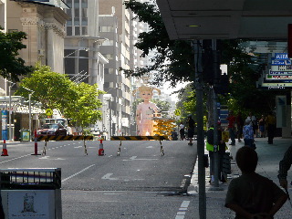

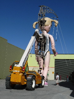

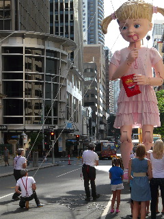

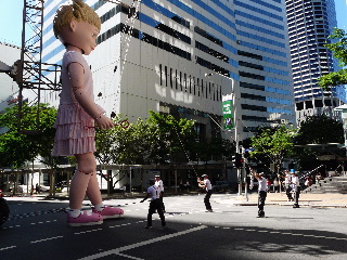

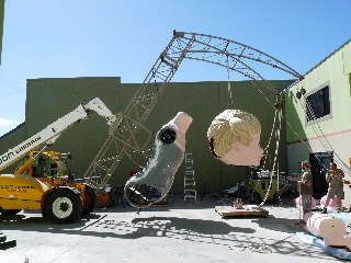

We’ve just filmed the commercial on the weekend in Queen Street, Brisbane, Queensland, Australia. The shoot was for Allens confectionary and featured our giant 30ft tall walking doll. Her eyes moved left/right, head left/right/ and up/down and her eyelids blinked, these were all operated by remote control. There were 2 people operating the arms and another 4 to make her walk. A large telescoping forklift or telehandler was connected into her back. This enabled us to move her forward and set her feet at the correct level to the ground.
Here’s the process from start to finish I’ll post a few messages with lots of photos.
I hope you enjoy seeing the process.

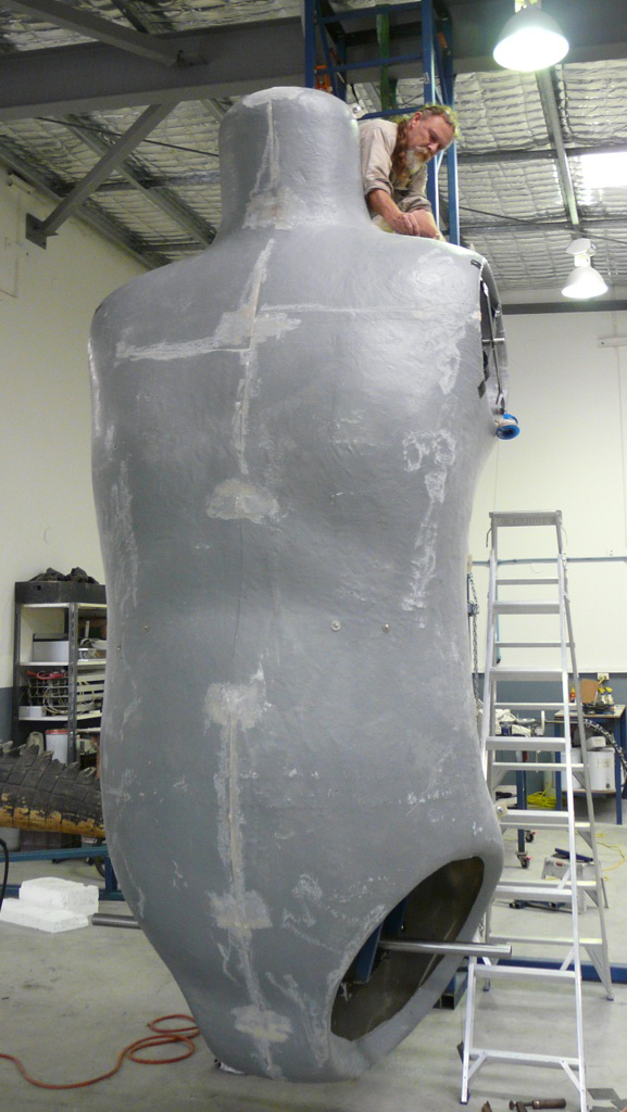

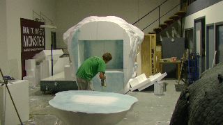

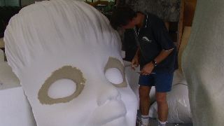

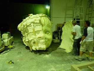

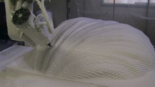

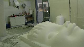

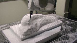

Our 5 axis router ended up cutting over 100 separate pieces for the doll.
[attach=137406]PIC_0014.jpg[/attach] [attach=137407]PIC_0018.jpg[/attach] [attach=137408]PIC_0032.jpg[/attach] [attach=137409]PIC_0029.jpg[/attach]

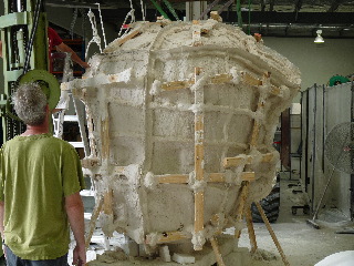

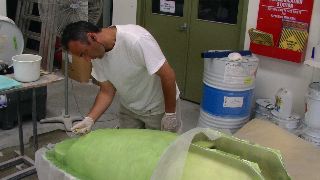

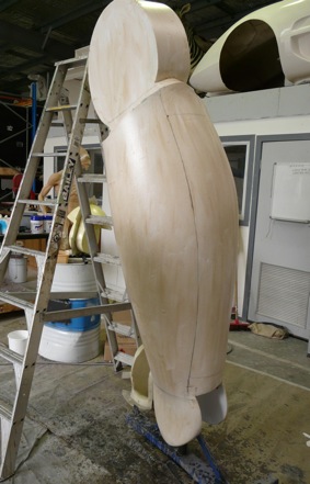

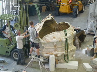

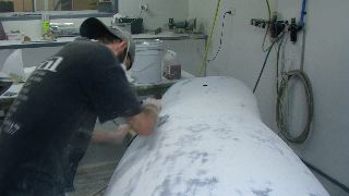

After the polystyrene was cut we put a layer of epoxy resin over it to seal it up then covered the pieces in polyester fibreglass. The pieces were then all split and the EPS cleaned out then they were faired, sanded and the mechanical components placed inside.This saved us the moulding process time.
[attach=137410]PIC_0006.jpg[/attach] [attach=137411]PIC_0003.jpg[/attach] [attach=137412]PIC_0016.jpg[/attach] [attach=137414]PIC_0025.jpg[/attach]

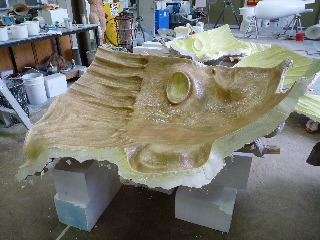

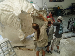

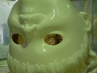

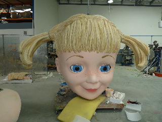

The only component that was made using a mould was the head as we needed to keep all of the detail perfect. The face is more complicated than an arm or leg piece.
[attach=137415]PIC_0019.jpg[/attach] [attach=137416]P1020017.jpg[/attach] [attach=137419]P1020023.jpg[/attach] [attach=137420]P1020033.jpg[/attach] [attach=137421]P1020034.jpg[/attach] [attach=137422]P1020048.jpg[/attach] [attach=137423]P1020057.jpg[/attach] [attach=137424]P1020060.jpg[/attach] [attach=137425]P1020089.jpg[/attach]

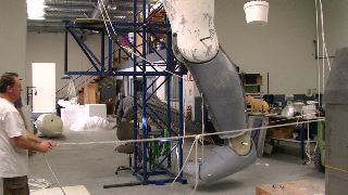

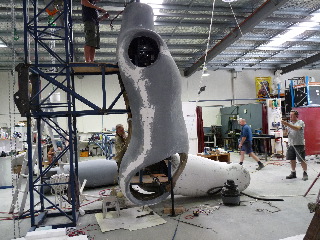

The mechanical pivot points were the most difficult to get right and required a lot of time. The components were drawn up in a CAD program which made the steel fabrication fairly straight forward.
[attach=137427]P1020030.jpg[/attach] [attach=137428]P1020103.jpg[/attach] [attach=137429]P1020150.jpg[/attach] [attach=137430]P1020153.jpg[/attach] [attach=137431]P1020042.jpg[/attach]

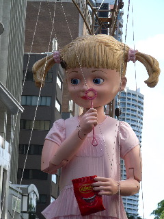

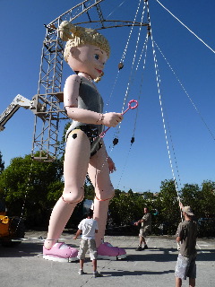

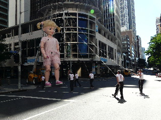

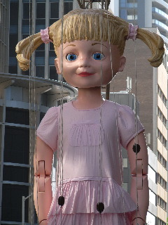

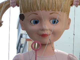

Here’s the finished puppet on the streets of Brisbane.

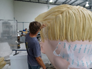

Oh, we started off scanning a real doll then manipulated the image in zbrush as I am a real novice with zbrush. The hair was done using zbrush and really helped smooth and style the pigtails.
Any questions just ask.
[attach=137432]P1070065.jpg[/attach] [attach=137433]P1020175.jpg[/attach] [attach=137434]P1020199.jpg[/attach] [attach=137435]P1070115.jpg[/attach] [attach=137436]P1070122.jpg[/attach] [attach=137437]P1070186.jpg[/attach] [attach=137438]P1070194.jpg[/attach]
