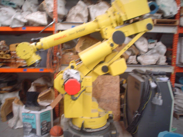

3Point14, 3, 4, 5 axis? Wood carving from ZBrush files is something I am going to try very soon. As far as an exciting “break in period”, one of the first movements I made with the Kuka was through the wall (didn’t even flinch, missed stud by “” that much). Quite a dangerous machine (moves faster than you would think). Post pics of your ZB to wood machine!
“one of the first movements I made with the Kuka was through the wall”
If you listen carefully… it can say ‘Wooosshhhhhhh’.
Quite a few years ago I programmed a pair of robot arms to shoot a tennis ball back and force for the Hanover Industrial Fair in Germany. That was a lot of fun. The arms served the ball to themselves… Not to each other. Was quite a spectacle. I used the teach mode to get them to do it. So no real ‘programming’ was involved.
best of luck and don’t let the KuKa steal your lunch!

Got the Kuka carving finally…Now maybe I can find the time to start feeding it some ZBrush files! Hope I uploaded the movie correctly at YouTube.
http://www.youtube.com/watch?v=SBUZqND7bhI
Cool! Instead of ‘just’ indexed, can it also run contiguous?
Great to see that you stopped poking holes into the shop wall with it 8)))).
Lemo
Hey Lemo…Yea, it can run any CAM you feed it in APT format. You have to simulate the CAM file first and fix any joint issues you come across…very different from a typical cnc machine. You basically give it a path to walk on and let it go for a stroll. Very little control over how it runs the path. You can’t really tell it what to do, you just give it suggestions until it gets it right. How are your projects going? Last we talked you were working with your casting. How has that been going? Jobs coming in at work-a-day job?

Lemo, Job as mold dipper…Ha Ha…the most over qualified mold dipper in the industry!! Though seriously, times are tough all over. I am going to Siggraph this month to see if I can scare up some work connections for the Robo. It’s not that I have no work, just not enough, but that is true for every job shop it seems. Just keep keeping on! Great that you have got your 5th working. Continuous 5 axis isn’t the holy grail…indexing can get you pretty much all there. The Kuka is sorely lacking in a 7th axis. Believe it or not, 6 axes with a robot limits you quite a bit…the working area of a robot takes some getting used to…spherical rather than linear. Maybe for Christmas I can get a rotary 7th, if I’m super good…Save me Santa!
I’ll try and post some more shots of the Kuka carving full 5 soon. Looks kool (way Terminator). We should be getting some more detailed ZBrush carves done as soon as the new collettes arrive.
7axis… hmmmm I recently build a turn table for a client. Can move 500 lbs. Stepper or Servo. Step and direction driven. If you can interface, we can do it without breaking the bank. I’m not going to Sig this year. Monstermaker did not let me sleep in his dog house… Said something regarding full moon, scratch marks… and fur again in the pool skimmer… lol
Lemo
Lemo, The rotary 7th is pretty standard stuff except: have to use Kuka servo. Have to use Kuka servo driver. Have to use Kuka wiring harness and cables. Sooo…a certain amount of up-front cost is associated with starting the build. Most of the parts can be purchased on Ebay, but the servo and driver must be matched. I am in the process of pricing out the parts to see if a build your own is worth it. I will get back to you about building it. As far as configuring in the controller, the Italians (QDesign) can remotely take care of most issues.
