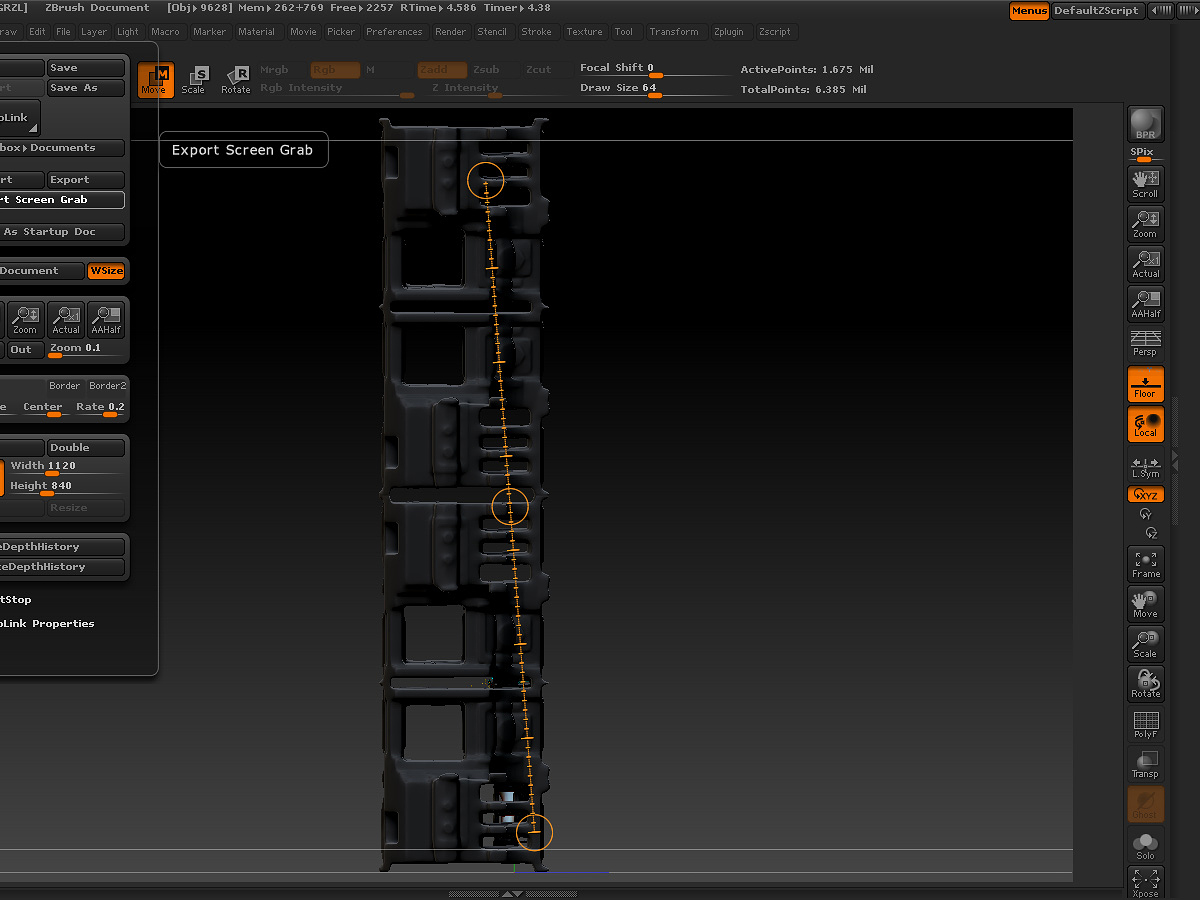

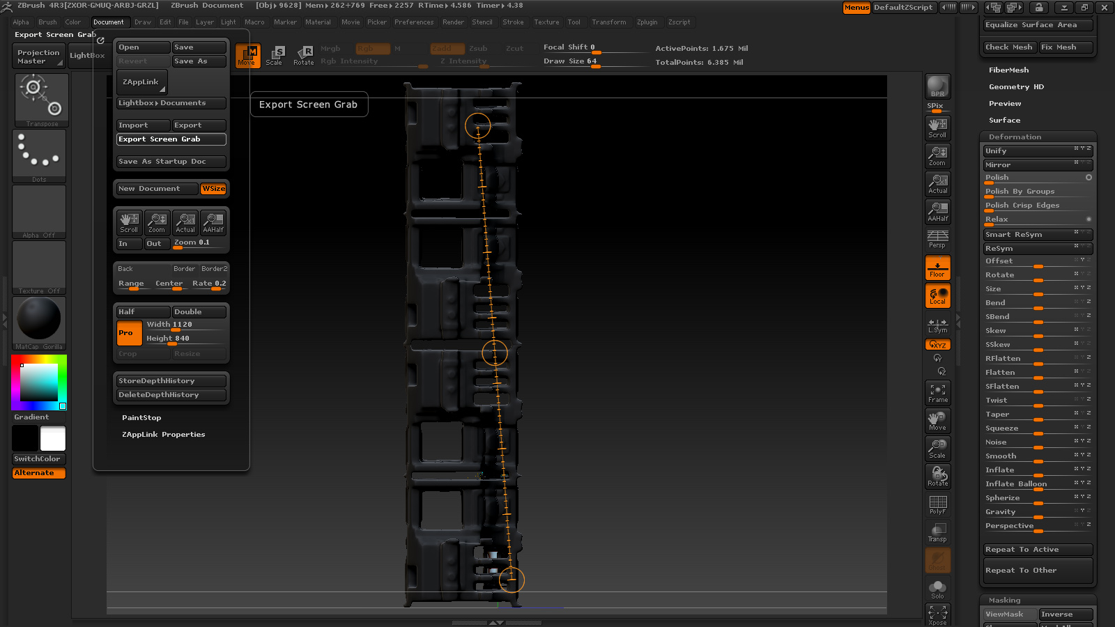

Im also running into stuff with the only workaround available, the transpose lines, this screen shot contains a transpose
line oriented to 0,0,0 and as you can see its off by a wee bit (also using Alt PrtSc doesn’t show the transpose line for
some reason hence the bloody document menu being open).
What I am trying to do here is so simple its disgusting and yet its totally impossible for some reason.
I guess what it boils down to is this:
Is there a precise method of moving tools and subtools that doesn’t crash ZBrush or do random things to my stuff?
I think I found the transpose problem.
You can turn on Align Action Line To Axis in the Transpose Pallet in the Preferences Menu, so far
it seem to be working and I’m thrilled! Not very precise but it is at least keeping things moving
in the right direction!
[EDIT] Yep! it looks like it works! Yipppppppy!!!
Hi Mealea,
Sorry to hear that you are having problems with crashing. I havn’t run into any of that yet in the Deformation palette. Regarding the Action line, instead of enabling ‘Align ActionLine to Axis’ in Preferences, you can just hold down Shift while you are drawing out the ActionLine to snap it to 45 degree increments and this will still leave you the freedom to use it freehand if you wish. Also, while using the ActionLine to Move stuff, holding down Shift while moving will constrain the movement to a straight line. I don’t know if you already knew this or not so I thought I would just mention it.

Yep, I have been using shift but it only works sometimes, and the screen shot is an example of it not working,
I was holding shift to get that line, from the “front” its perfect, but from the side its not (as you can see).
What it seems to be doing is snapping to the nearest vertices like it describes in the tool tip thingy for the
stuff in the preferences, but that button fixed it so I’m almost totally thrilled.

When your drawing out the ActionLine, start on the mesh but pull the end of the ActionLine out to an empty spot on the canvas. This will keep it along the axis to whatever view you are snapped to.
THAT is interesting…
When I drew the one in the example I couldn’t see the background, I was
working on a small subtool in the middle of a large wall.
Hmmmm…
Thanks ZBer!
Im going to try that now!
Yep!!!
That was it, I can see (while holding shift down) the line conforming to the surface under it and once
\its clear it snaps into place.
The problem now is that I need it to ignore the things under it so I can work on little stuff, but if I zoom
out and make the action line when I zoom back in the little grabby thing at the end is off the
screen.
So… I think in this instance the thingy in preferences is the way to go?
hmmmm…
If your mesh fills the entire document, you can Zoom (Zoom Document) out so you have a bit of empty space outside of the document. Dragging the end of the ActionLine to the outside of the document will also draw it on an axis. Otherwise the ends of the ActionLine will just follow the surface of the mesh.
