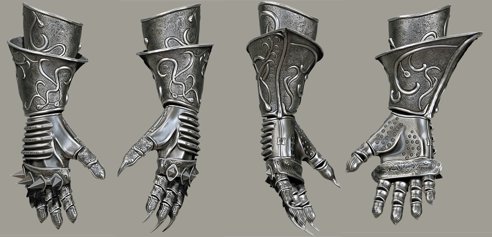

so here s an update, hands…

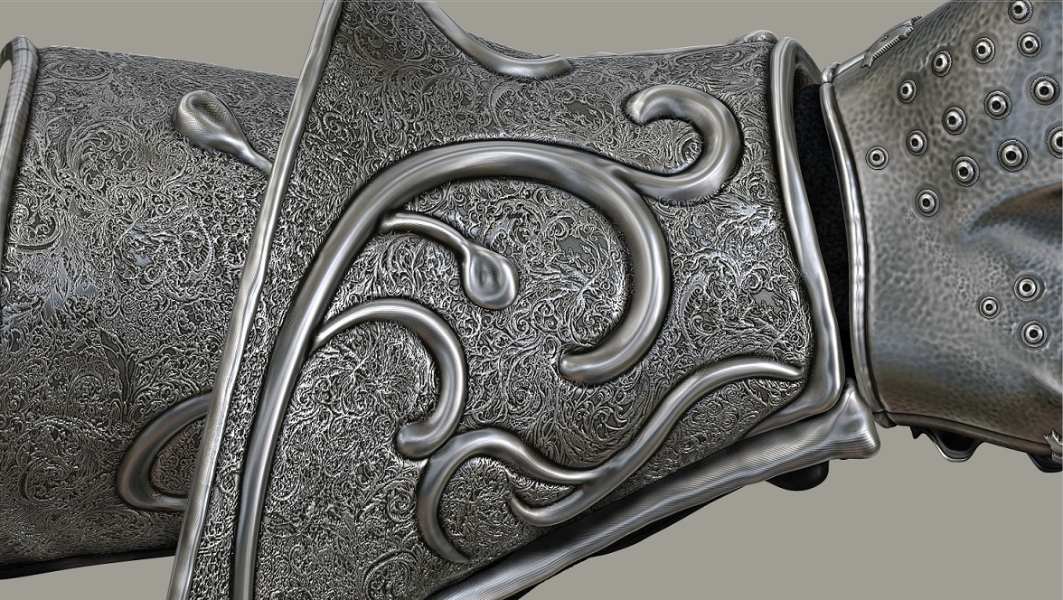

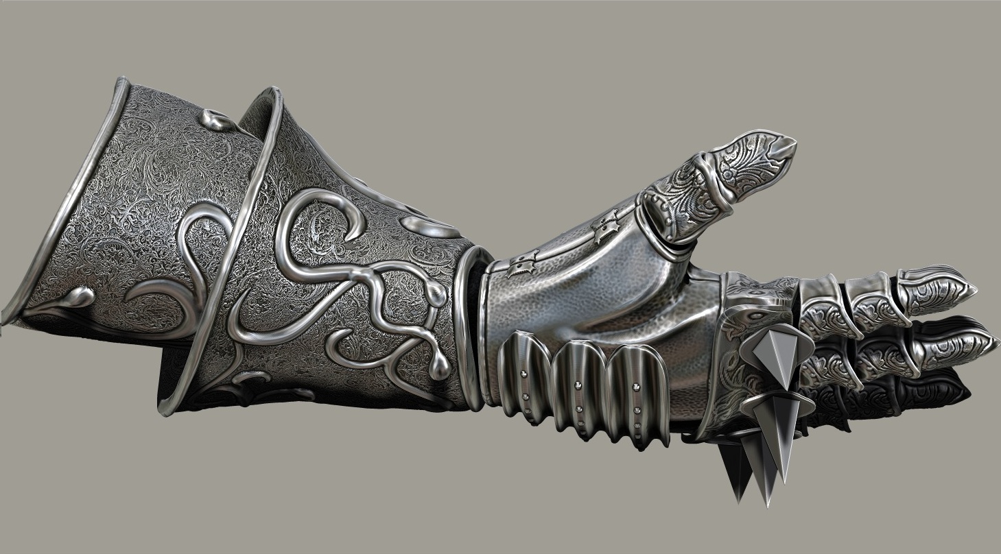

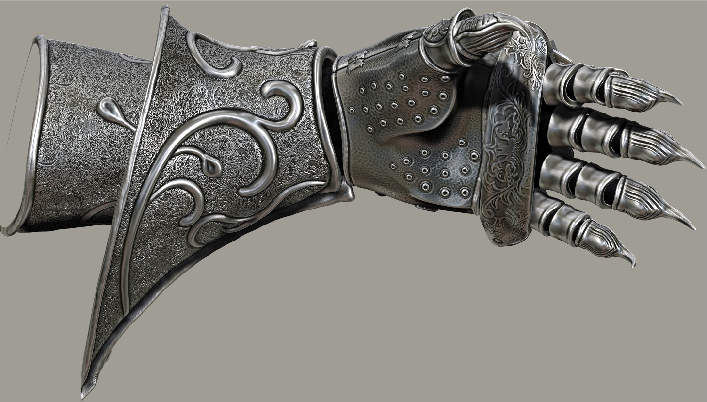

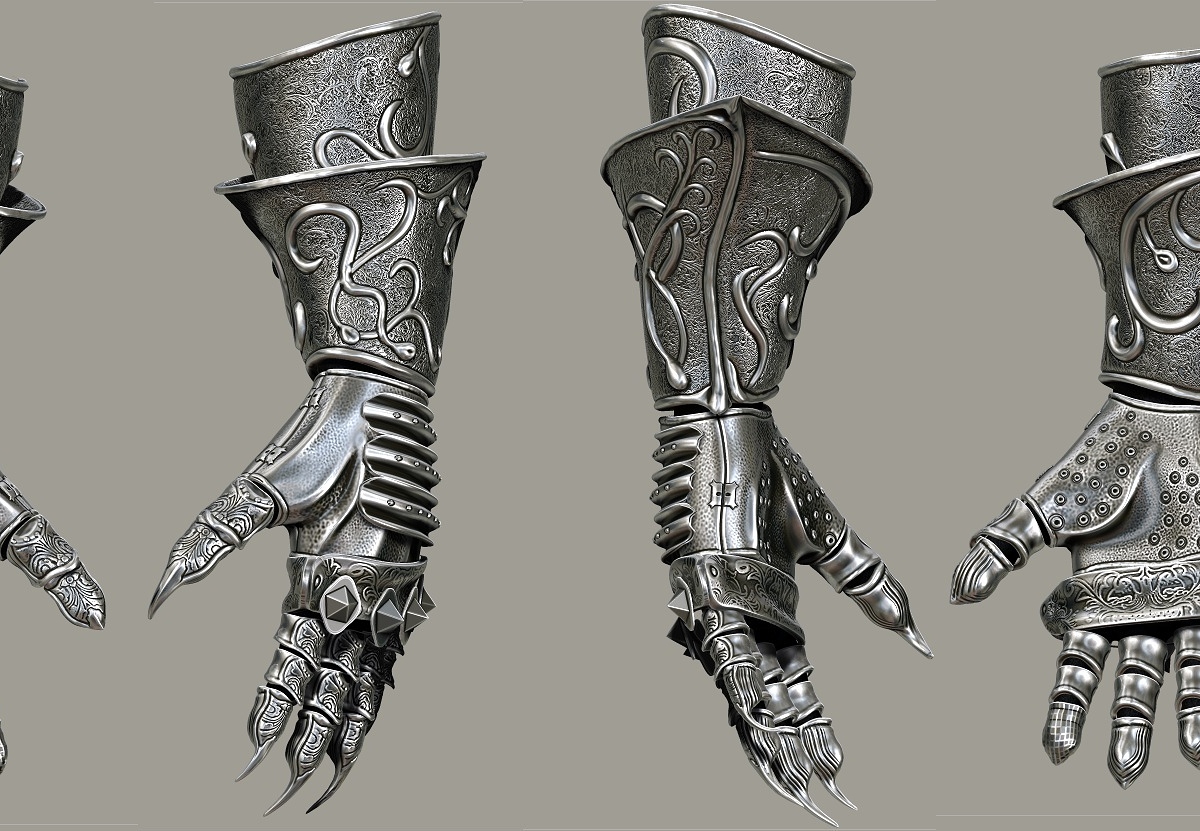

so here are a couple more snapshots
and a closer one where you can see all the imperfections
