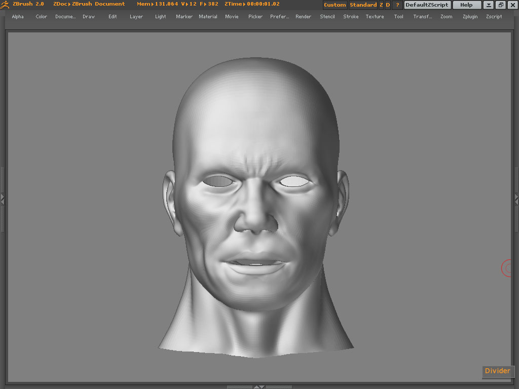

head_front.jpg hello mates…i made a base head mesh in MAYA with proper flow, then i will work in ZBrush…then i want to bring it to MAYA again after finishing it in ZBrush to make it an animatable mesh, how do i do it? do i do it through displacement map? if i hav to do it through displacment then how? and i have to apply texture on it with hair, how do i do it? whether i aply texture in MAYA or ZBrush? plz help i am new at ZBrush and MAYA integration
