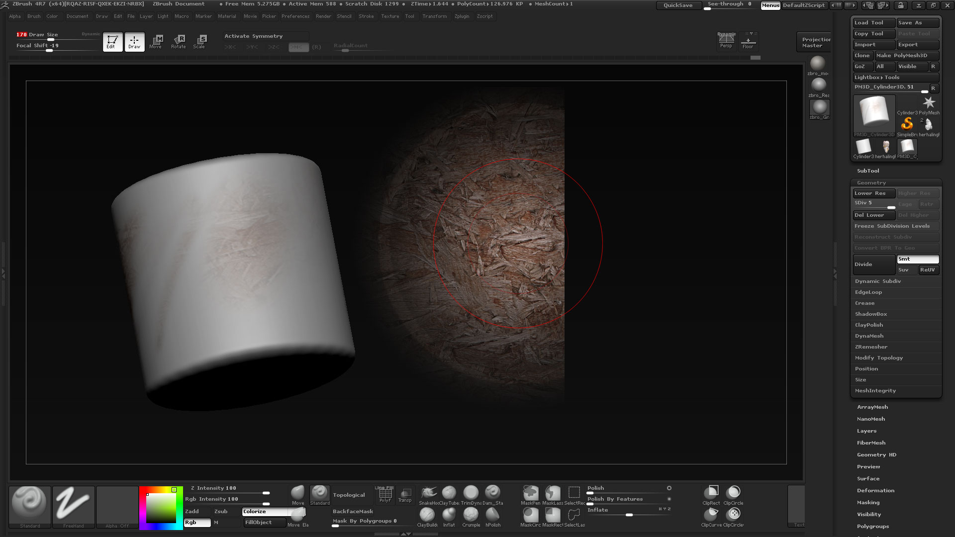

Something strange happens when I want to use spotlight for texturing. it doesn’t do a good job projecting the texture on the model. I really have to pushy extremely hard on my Wacom to see a little bit of the texture painting. I really never had good results texturing in zbrush. what am I doing wrong? thx oh and my rgb is set to a 100.

You mean polycount? tested it on a 8 mil. asset piece still the same issue.
It says ActivePoints and TotalPoints in my interface :wink: There are settings under Picker that will affect this operation. The objects orientation and shape play into this as well.
The Tip Feel might be too Firm. Try going to your Wacom Properties and set Tip Feel all the way to Soft and see if that makes any difference. I have mine set mid way and don’t have any problems (Intuos 3).

thank you zber2 !!! its solved. finally it was making me crazy. the tip feel was the problem. thank you all for your time. appreciate it.
