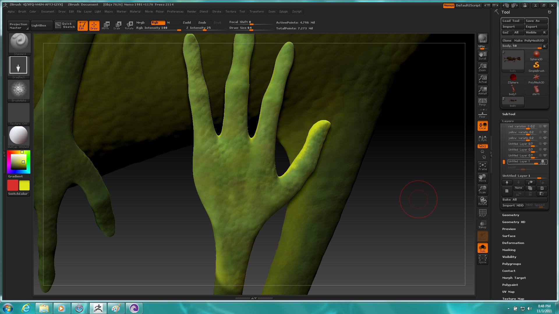

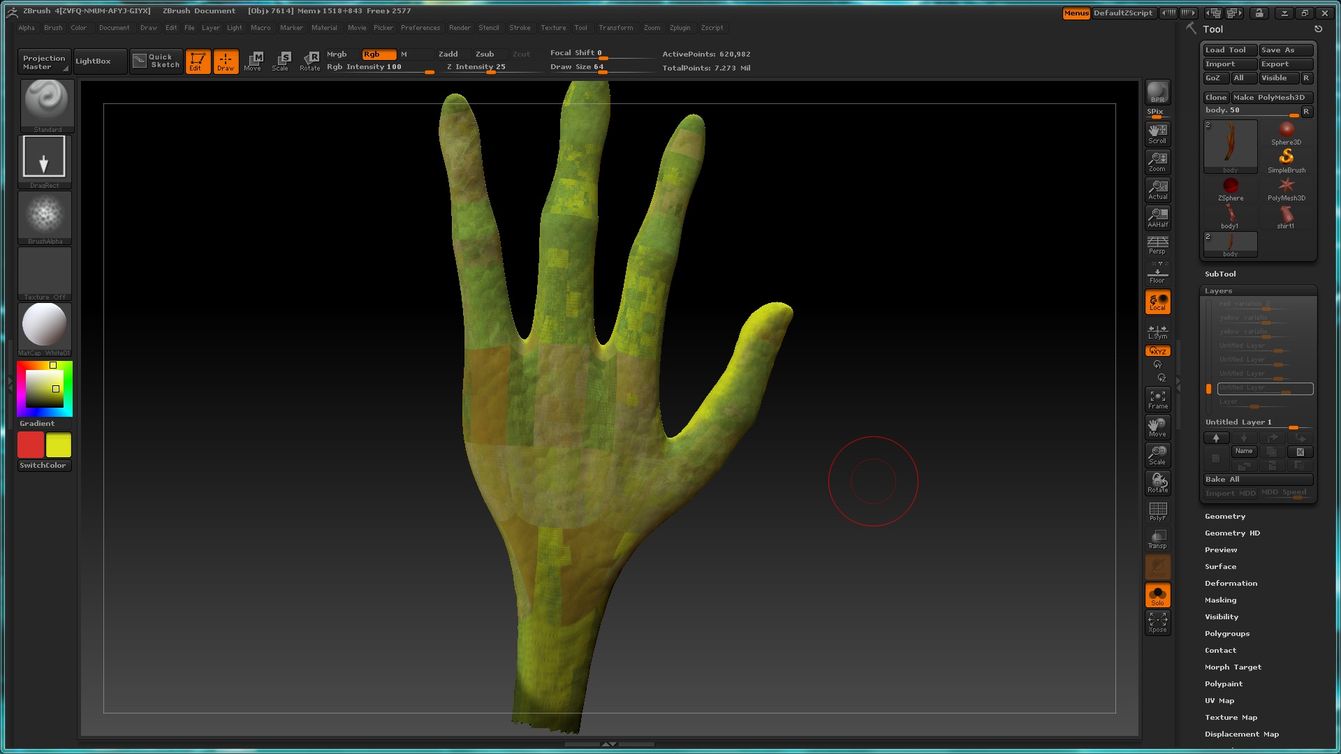

hello to all the respected seniors.i have issue while working in isolation mode while texturing(in layers mode only).i am working in layers texturing ,isolation selection works fine when no layer is on.the moment i start recording layer and then select some isolated part the whole textures turn pixelated.in that case i cant texture my object in proper depth easily
uploading both images with and without isolation mode .plz help me .thanx in advance :slight_smile:
Try breaking the model into separate SubTools instead. So long as the UV’s are assigned before you do this, you can easily merge your maps after you’re done.
