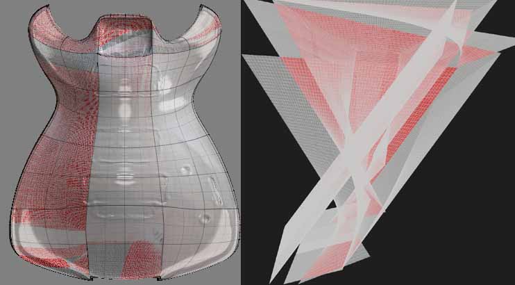

Well, without being able to see what you mean by “goes nuts on me,” we can only guess what’s happening. The best guess, though, is that your model is either not UV mapped, or it has bad mapping. For example, Max needs to use a “# of Digits” setting of 6 in order to export the UV’s correctly.
Press Tool>Texture>Uv Check. Does any part of the model turn red? If so, then you have overlapping UV’s. Now press Texture>Crop and Fill. Do the UV’s look like they should, or are the garbled?

Anyway heres the problem
 one pic show uv the next is after cropping. kinda funny and sad at the same time.spider.jpg
Yep, the problem is the model’s UV’s.
The easiest fix:
  1. Create a blank texture for your model of the size that you wish to paint on and eventually export.
  2. Press Tool>Texture>GUVTiles
You will now be able to paint successfully.
That fixed it thank you. now I know how to fix that on almost all of my projects.
