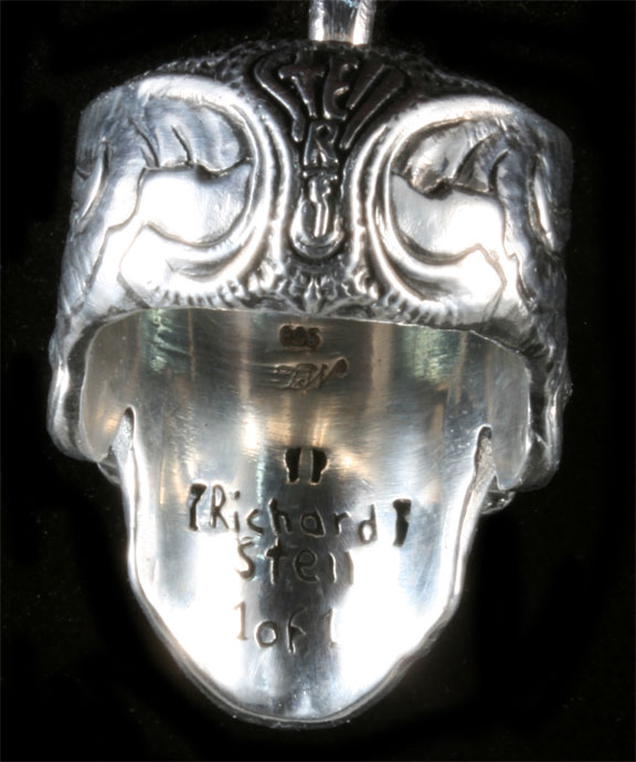

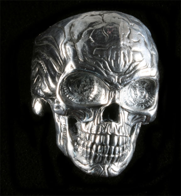

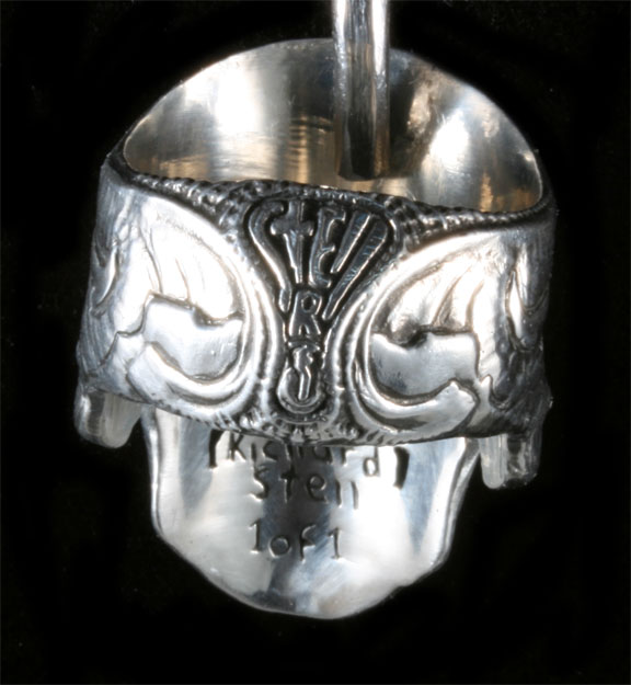

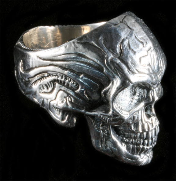

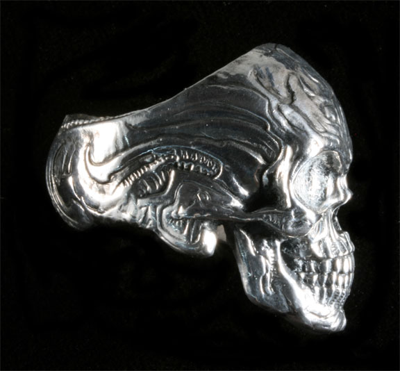

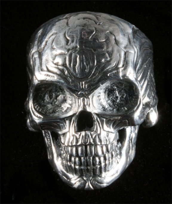

here are pics of the wax I posted in silver back from the foundry…
still waithing on pic from the foundry.
and still looking for those pics of the grown parts…

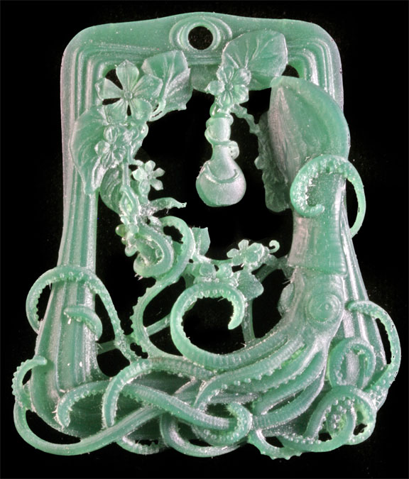

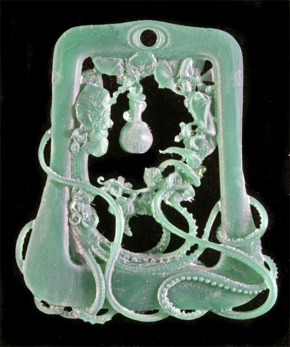

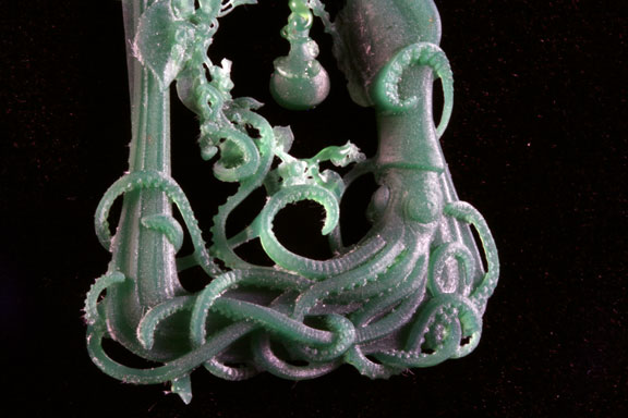

here is a pic of the squid wax.
this one is a little screwed so I did a little redesign as far as the thickness of the leaves and vines.
i’m milling that out as we speak.
more pics to follow soon

here is the new wax…
Turned out great how large is it?
50mm x 60mm
It’s a little bigger than most my pendants but it lays well I think .
another reason for it being a little larger is I want to make a small attachment for the top so you can also wear it as a broach.
something different, trying to keep more wearing options open.
