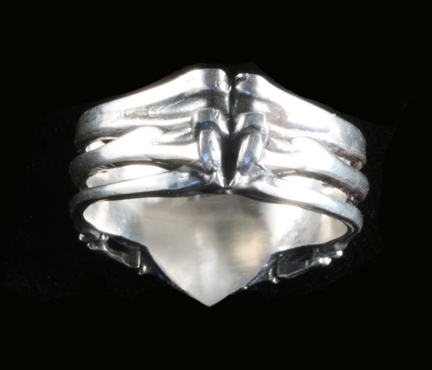

01.- The rings have been milled in several pieces, isn´t it? How do you put them together, with melted wax as glue?
no most of these are milled out of one piece of wax that way I know they can be fabricated with oput too much drama. if they cant be done out of one piece I normaly grow the pieces.
02.- Do you have any problems with these complex shapes when you are making the silicon mould?
Tons… but I use the casting house in chicago. they are using a true wax process. it is a high def waxing process. they fill the mold with a liquid and cure it with uv light. veeeeeeery cool.

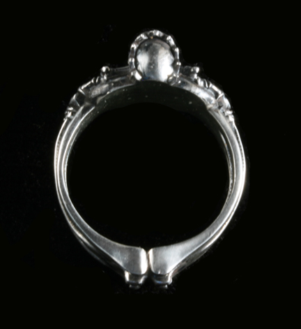

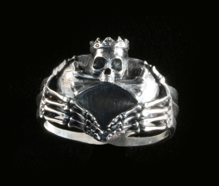

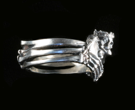

here is a new bigger style claddagh with a crown.
people wanted a crown who am I to say no…

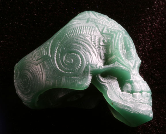

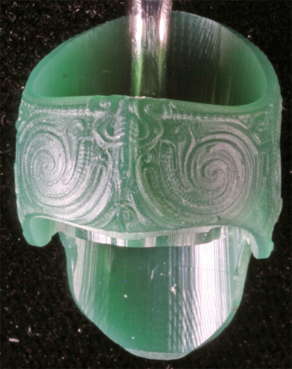

actually all of the waxs posted are off the mill.
I use profile cutters that leave an amazing surfaces. I know it’s hard for me to beleave as well. I was at a symposium this weekend and the new version of my mill is even more impressive. the software they have created for 8 path passes is staggering. and honestly I love milling just for that reason the surface is great and getting beter every day.
but I’ll post pics of my next milling directly off the mill, without rinsing it off so you can see them.

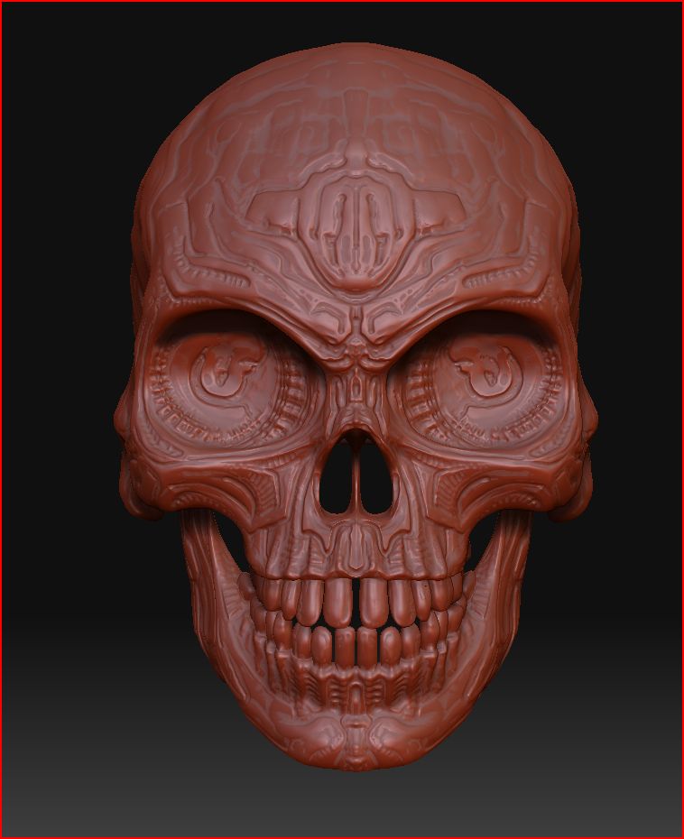

here are some new parts.
I know beating the skull thing to death but it’s what people keep ordering.
I have some non skull pieces comming soon I swear.

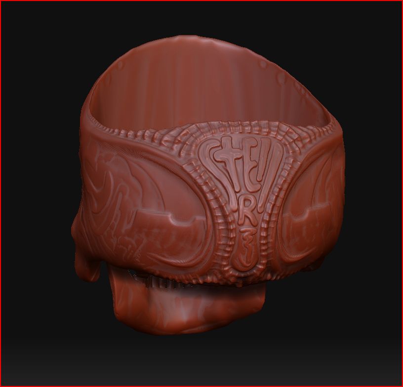

the first piece is a custom part for the tattoo artist Richard Stell.

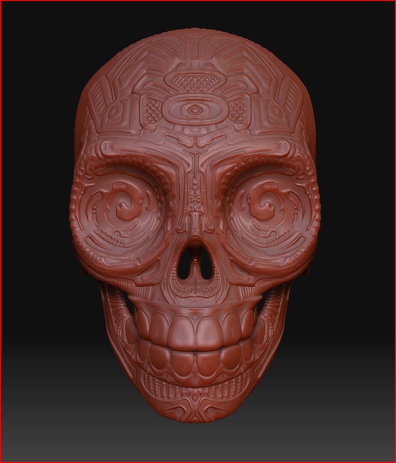

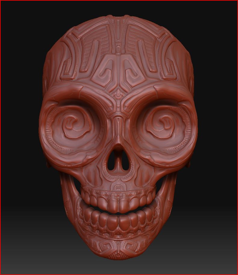

then the others some more primiteve shapes the one has the mayan number 0 on it’s forhead.
as soon as I’m givin permission I’ll post a part I was working on as a commission piece.

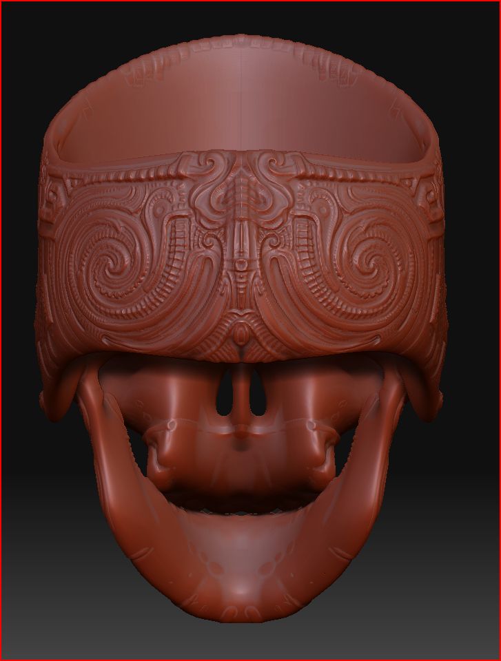

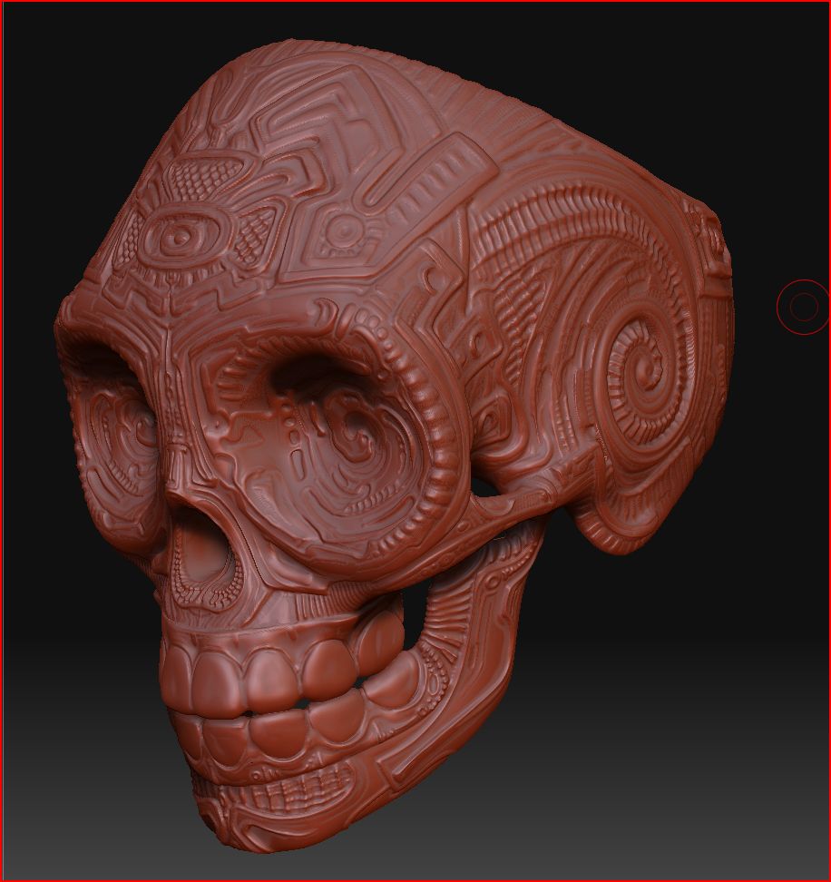

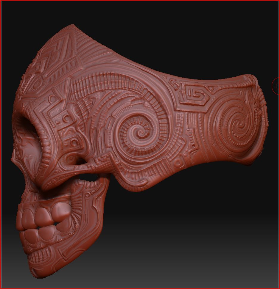

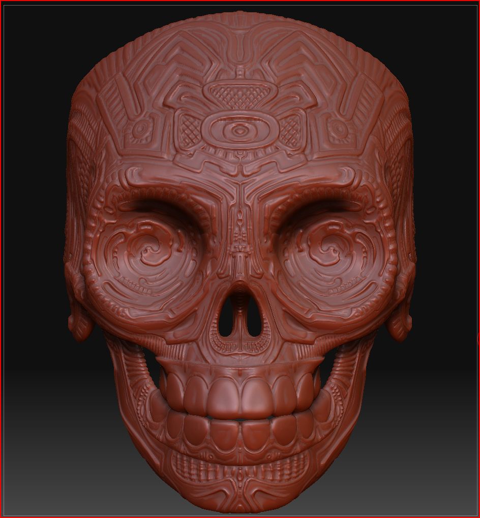

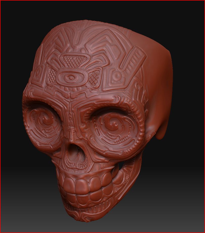

mayaish skull ring …
I think this one will produce well.and it’s kinda fun

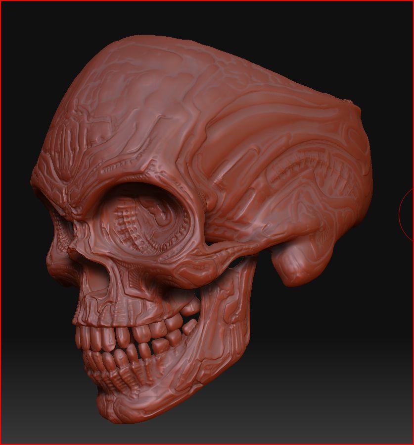

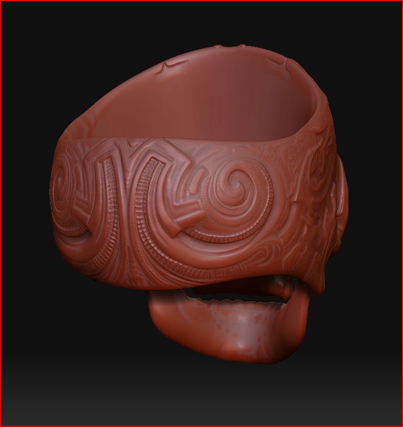

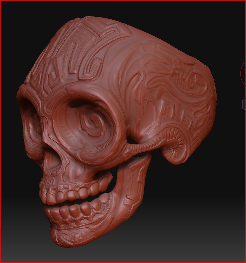

What’s the polygon count on that? I can tell it has to be high for the detail to be so nice. Can Matrix and the mill handle so many polygons without crashing?
Adio- that would have been nice to see. it was a rough image they had.
DanasArt- I usually work in the 1 million poly range I think because how I saved the initial base of this one it got up to 2 million or so.
I found that after sculpting instead of decimating it in another program I can reduce the level in Zbrush and loose far less fabricatible detail.
I am able to use anything in the million range inside matrix to build my tooling paths.
some times if it get past a million polys it’s hard to get a revo file built of lets say a 6 degree cutter with a .001 tip. on a extra fine path.
on something that fine it’s my mill that craps out on memory.
I put more ram into the mills computer, it has 2 gigs now.
I think the biggest revo files I can run without any problems is in the high 60mb range… yup the richard stell ring was 67mb i had to reboot and reload that one a couple time until the mill took it.
this ones Rvo file is 38mb I think it’s export size coming out of Zbrush was in the 650,000 poly range.

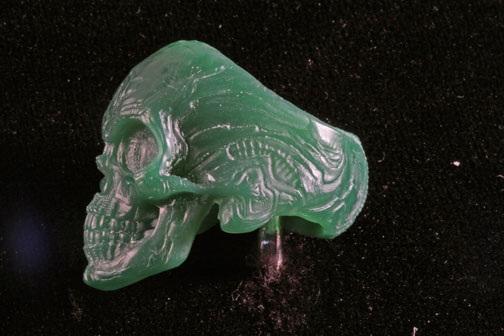

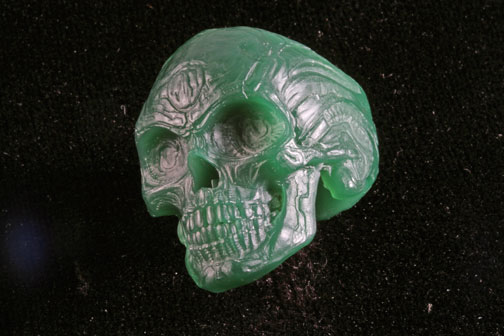

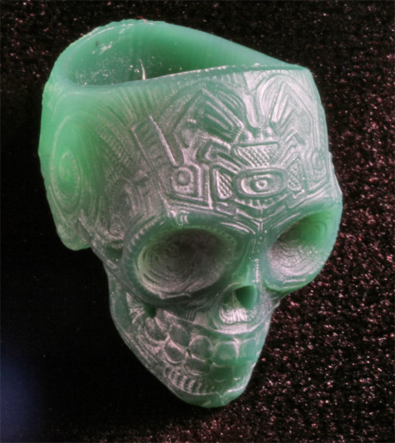

this is the wax of the above model. just off the mill.
I usually now sit down and with my visor and hand tools will cut and punch the details, hollow out the weird parts and all that stuff the mill cant get to.
I’ll post a pic of the finished part after the hand tooling as well it has to be done tonight.
