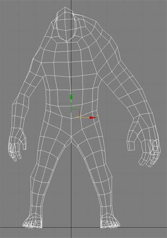

Max screenshot of symmetry location:
http://img.photobucket.com/albums/v307/JVI/symmetry-max.jpg

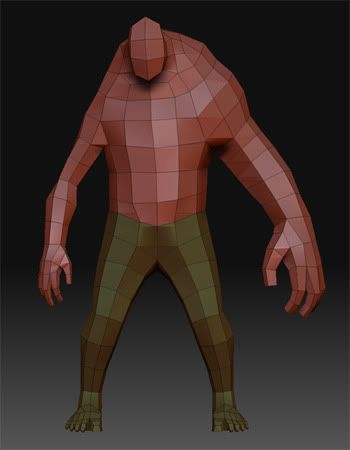

Portion I want to use symmetry on:
http://img.photobucket.com/albums/v307/JVI/wanted-area.jpg

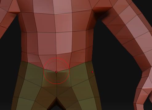

Symmetry with C-Pivot:
http://img.photobucket.com/albums/v307/JVI/c-pivot.jpg

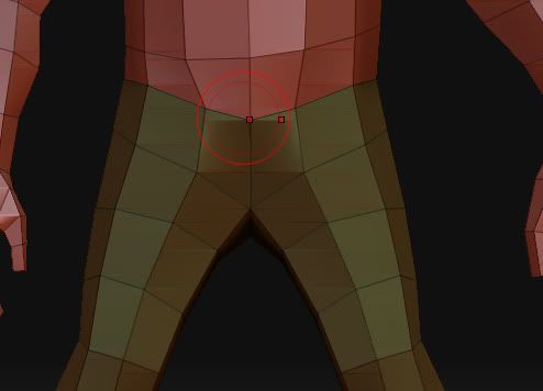

Symmetry with S-Pivot:
http://img.photobucket.com/albums/v307/JVI/s-pivot.jpg

hide everything but 2 symetrical polygons on the legs or feet…the exact ones on each side.
then hit C pivot…or S…i don’t remember which one moves the model.
then unhide everything…should be all set.
Great worked like a charm! Thanks a ton :slight_smile:
