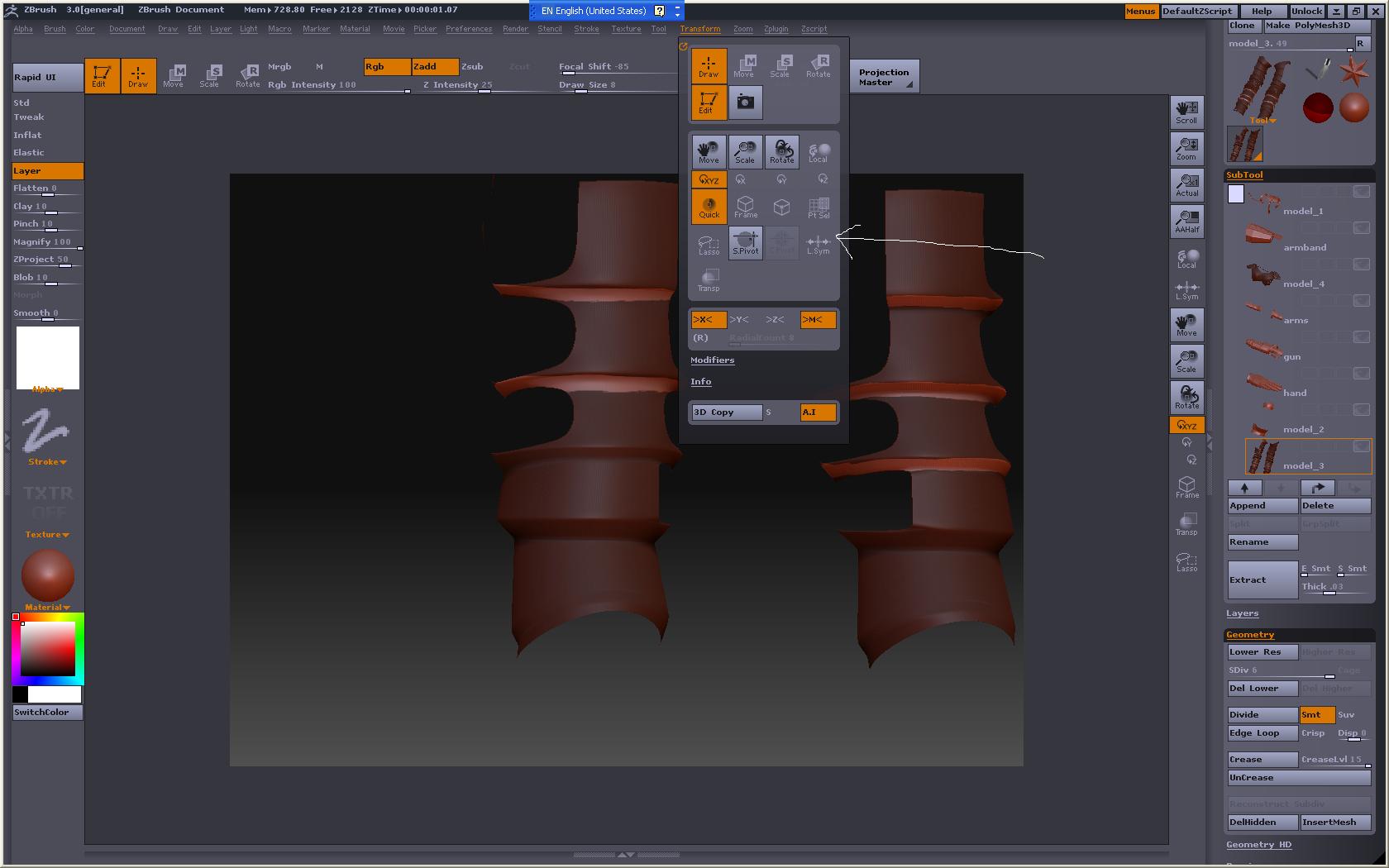

I am following a tutorial dvd, and the instructor can use the sym dot function in mask mode too. I also noticed from looking his tool screen, L.sym key is off (gray not yellow) but he can use the sym dot function.
If I turn off the L.sym key, I can’t use the dot function…
Check the picture that I attached, and look at the white arrow. Without the L.sym key, I can’t use the sym dot function…but I can see the tutorial screen, the key is off, but the instructor still uses the sym dot function.
Please check the picture that I posted and tell me what I need to change.

Aurick…sym isn’t used when masking?
gorillajin - are you talking masking on the model, or masking with the lasso or marquee
I am talking about masking on the models.
As you can see the picture, I am trying to use masking on my models, but sym doesn’t work in this mode.
