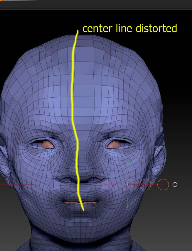

Hi, I found symmetry center line is distorted after I slide some parts using “move transpose tool”
Using Smart Resym not works on center line, I think.
Any way to fix this?
You might try running the Transpose line fully across the head first so it scales evenly across.
Hi, thanks for the reply.
I tried placing the transpose line across, however, I think it didn’t work…(not sure I did follow what you said)
What I came to notice is no more using move but scale transpose.
Placing transpose line vertically and scale, makes no distortion.
