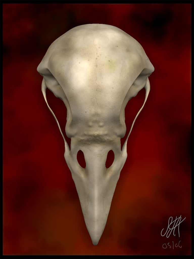

Just started on an idea, and needed to model a crow Skull this is where I’ve got whith it so far. C&C’s all welcomed
The bird skull looks good. Ho do you create the holes like that? Can you show me a bit more?
HI SolidSnake
Thanks for your comment. The holes ar created by hiding Polys and deleting them. I modeled it from ZSpheres and got the main shape for the skull and took the poly level up to Level 3-4 in detail.
Once satisfied with the shape, I deleted the lower levels, went to project master and painted in where I wanted the holes. but keep the marking smaller than what you actually want ( I’ll explain in a bit)
Once you’ve marked out your area’s, leave PM and turn texture to Alpha, go to masking and mask from alpha, inverse mask, hide and delete hidden polys.
The holes will look rought, not to worry though, this is why I say keep the markings smaller than the holes you want. you could take the level up higher and get a mor defined shape to your hole.
Save a morth target, and in displacement inflate about 12% and morph difference.
Take new model and use smooth tool to smooth of the edges of the holes.
And hey presto you have your Holes for Skulls. Don’t know if this is a proven teq, I came I had the idea I guese from Meats Teq. and jsut adapted it to what I needed.
Great modeling and good use of morph difference & masking.

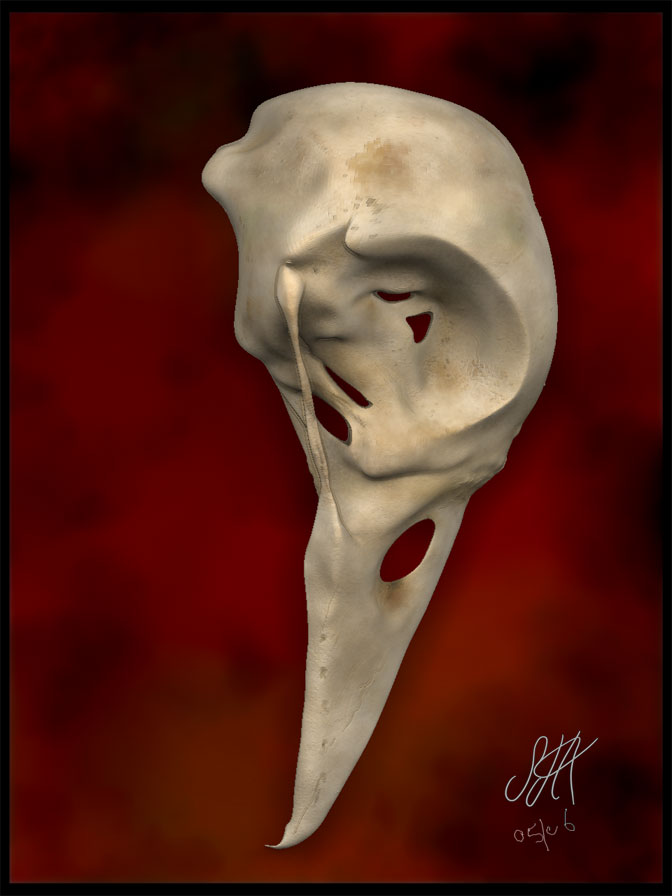

thanks for the comments, here are some clearer renders, with the first Texture render. Also for anyone interested i’m posting the bone material
There still some trweaking, to do for the overal shape, and few mor minor cracks to add to the texture.

Thanks Boozy Floozie, and I’m gonna have to go and try the tech. on the link you gave. From a quick read its seems like I went the same way only i used the morph feature instead of unified skin. the one problem I find with the way i went is that by deleting the lower levels leaves you with a high poly count on level 1. Which means a large file size when saving.
So I will have to read and play a bit to see if your link will help me round that problem. it may be usfule for some of the other parts I need to model for this piece.
