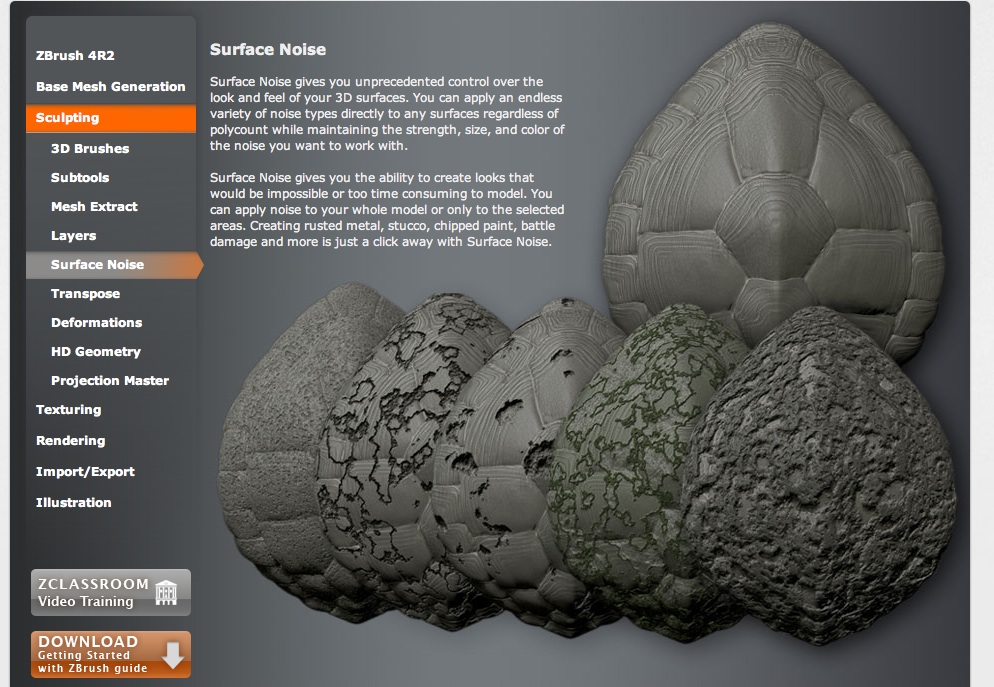

Hello all, I’m a noob so excuse my noobness but I am trying to recreate an image like the one attached. I’m using the noise curve and I can’t seem to replicate the look of these images. Mainly the second third and fourth shells from the left. I’ve played with noise curve for a few hours and I cant’ seem to get close to these. I was wondering if there members have posted their own .znm files to down load. Similar to downloading materials and textures. Also is there a way to delete edit points that you’ve placed on the curve. I see the undo button but if you want to remove a point you placed in the beginning is there a way to delete that point?
Just drag the point outside the curve window
Thanks Richard I’ll give that a try. Have you been able to recreate the noise patterns like the ones on the tortoise shell?

To get that outline look in the second shell put a little peak in the profile curve graph with most of the graph being off the bottom.
-Joe
Joe,
You are a rock star! Thank you for showing me how you reproduced the noise from the shell page. I would have never thought to move the right side of the cure to the bottom. Very impressive and I owe you one.
