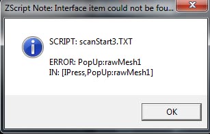

I get the below error when I try and create a macro that imports two OBJs and puts one as a subtool… it never ends up putting the object in the subtool…
Any ideas?

Hmm… ok…
I just tested Macros with Subtools using objects that are preloaded in ZBrush… and it worked.
So it seems like it’s something to do with objects that i’ve imported that is not allowing me to append a subtool.
is there some limitation in filenames? paths? that I could be ignorant of.

Macros can be tricky like that but the solution depends on what you are trying to do. For example, do you want your macro to give you the option of choosing the OBJs? Posting the whole macro will help as it will need editing.
Thanks for the response. Yeah, basically I want to import two objects and make one the subtool of the other.

Ahh is there an issue with creating a subtool in macros. I’m trying to import 2 obj files…
I thinks it seems like it’s something to do with objects that i’ve imported that is not allowing me to append a subtool .

Here’s a macro that will do what you want, or you can adapt it to you needs. Copy the file to your ZBrush 4R4\ZStartup\Macros\Misc folder and press Macro>Reload All Macros or restart ZBrush. There will then be an AppendOBJ button in the Macro>Misc folder.
The macro works by reading a text file. I’ve set this to ZBrush 4R4\ZScripts\AppendList.txt but you can change this to anything/anywhere you want by editing the fileListPath at the start of the macro. (Note though, it’s probably not a good idea to store the file in the Macros folder or subfolders as ZBrush will try to load it as a macro.)
The AppendList.txt file has the file names and full paths for the OBJs you want to use. The list is simply the file paths, on separate lines, e.g. :
C:\Users\Marcus\Desktop\Body_1.OBJ
C:\Users\Marcus\Desktop\leftArm.OBJ
C:\Users\Marcus\Desktop\rightArm.OBJ
The macro will load the first file and then append the remaining ones, so long as the files actually exist. It will append any number up to 100 OBJs, though again you can change this if you wish by editing the maxAppend number at the start of the macro.
I’ve commented the macro so that anyone who’s interested can see what the code is doing.

It’s the selecting from the pop up which is tricky. For some reason it requires a full path which is not provided when the macro is just recorded. The [IGetTitle] code corrects that.
In general macros work very well but sometimes a little editing can make them much more useful. ZScript is not too difficult once you get started.
