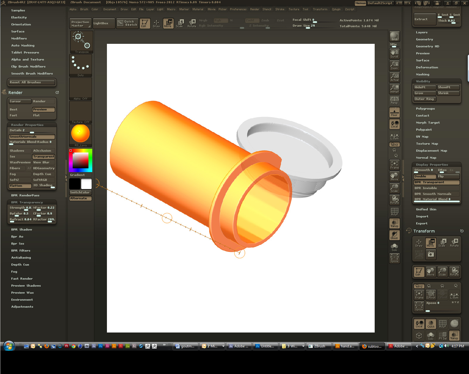

I tried searching for this but couldn’t find anything dealing with this exact problem. I’m trying to render a subtool partially transparent. I can get the transparency to work in that I can see other subtools through it, but I can seem to get it to show the other side of the mesh. I’m working with a prescription bottle model turned on it’s side. I can see the pills through it but not the other sides of the bottle model. Surely there is a button or a slider I’m missing?
im pretty sure what you wanna do is go to tool>display>double. this will make faces double sided so that there is no back face culling, which is your problem.
Thanks! I tried that but still no luck.
Your normals might be flipped. Go to Tool > Display Properties and click ‘Flip’ button.
If it’s not flipped normals, can you post an image of the problem. Always post an image whenever you can.
Here’s my image with the interface showing. I’m obviously not a master modeler, so that may be the issue. But I basically trying to figure out how to see the bottom of the bottle with the render. I did try the “flip” button too, but this the the result I get. I really appreciate you guys taking the time to help me out.
OK. I see what you mean now. Your expecting something like a glass render. Your not going to get that in ZBrush. Transparency in ZBrush is not the same thing as it is in other 3D apps. I don’t think what your trying to achieve is possible in ZBrush unless there is a way to fake it.
Well schucks. Yes a glass render, I should of thought to describe it like that. Thanks for trying!

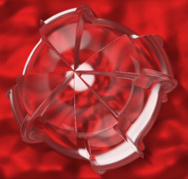

I created this many years ago when I was first learning ZBrush, but I don’t remember how I did it unfortunately. I’m betting I faked it somehow using materials/shaders, because ZB doesn’t support refraction (yet).
