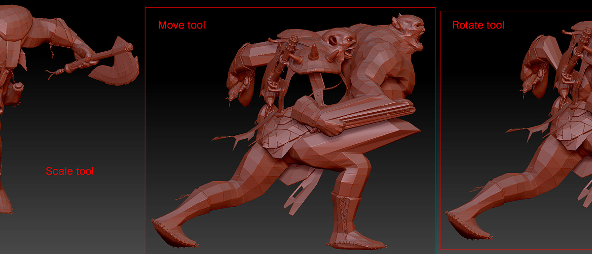

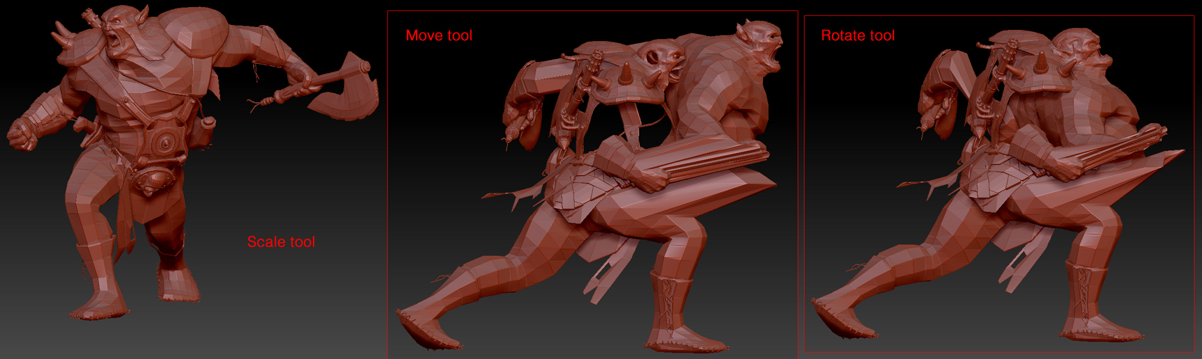

I am even willing to loose the 7 layers of detail (mutter/grumble/heh) if I must and start all that over, but after I joined the objects together and scaled it properly to “work around” the problem listed previously (the knife was the object that was not importing properly) I no longer have the ability to use anything other than the scale tool as you can see it is working properly. The move and rotate tools give the result shown (there is no masking in the scene).
Any ideas?

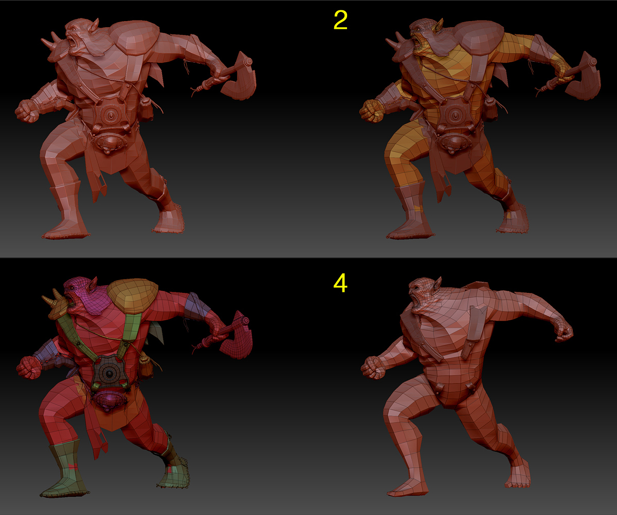

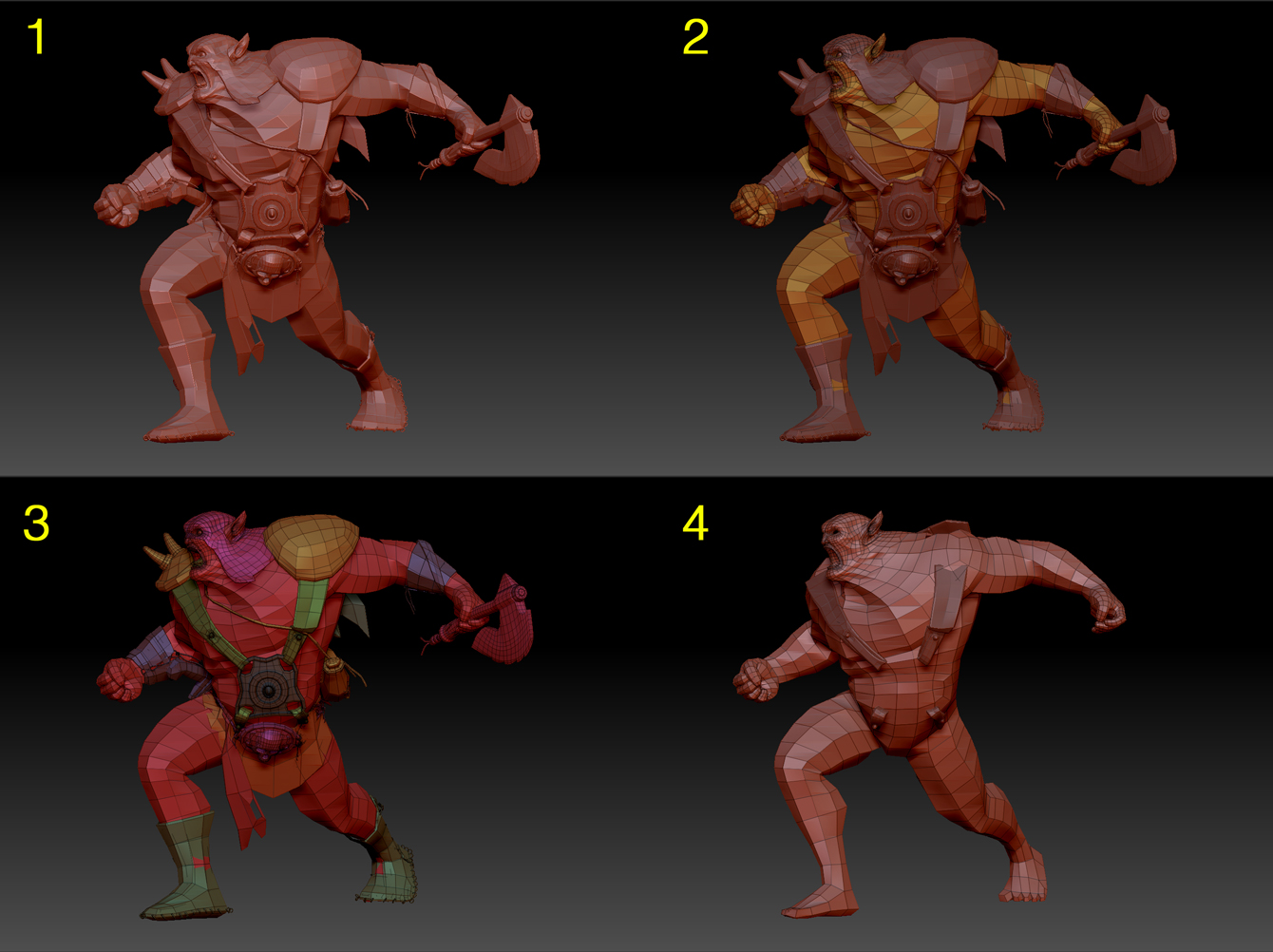

Ok - I believe I have isolated the files as NOT being the problem. I don’t see how it can be. I took the entire mesh as an OBJ and took it back into Max and ensured that ALL subtools had a “zeroed” out axis at 0-0-0 then followed these steps:
  1. Imported it into zbrush as a single OBJ
  2. Turned on Wireframe and did a group split
  3. Used TPose to combined all newly made subtools
  4. used TPose to separate all subtools back - here is where the problem arises - as you can see there are trools missing completely from the view - they are still in the side subtool panel, but they are not showing anywhere on the screen - I have even tried to find them using the “frame” button - no luck
What further makes me believe it is not the file is that I have done this three times and each time I got a slightly different result - always items missing, but not always the same items.
Any clues?
