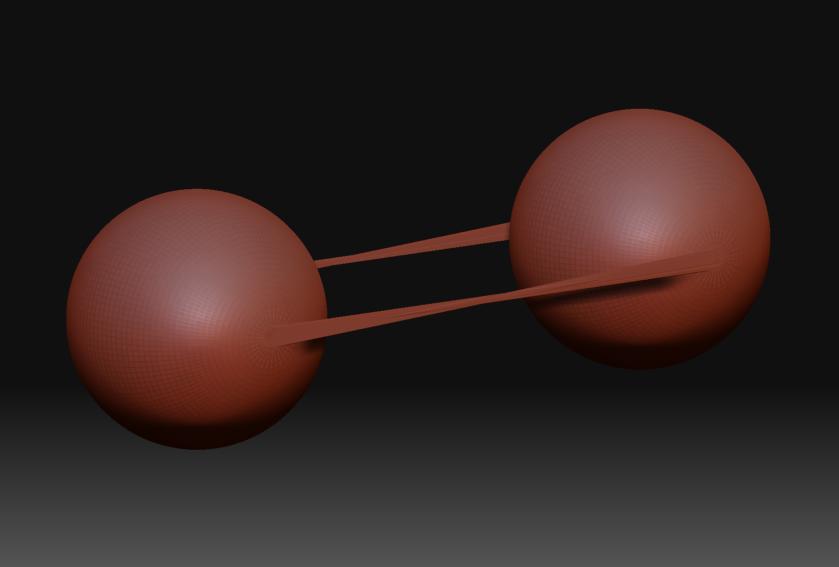

I made a simple mesh in Blender and and I exported in obj and imported it in Zbrush to sculpt some details on it. However, when I try to subdivide my mesh, 2 vertices moves. I do not know what happened, the two vertices seem to go in the middle of my mesh. Here a screen to show me problem. The left side it’s before the subdivision, the right after.
Does someone already see this and can help me or refer me to a thread that explain and solve the problems ?

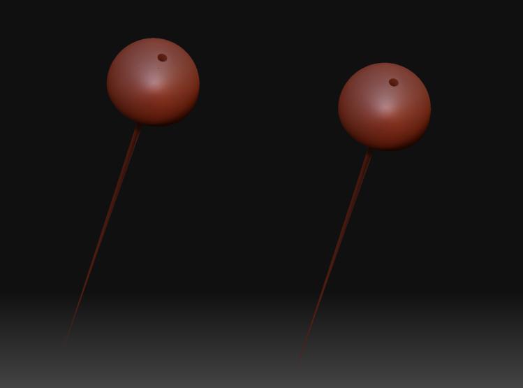

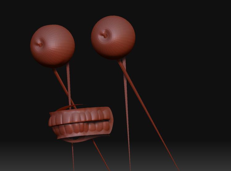

I’m having same problem with a lot of my imported .obj’s as well. I’ve imported .obj’s I’ve made in 3DS Max, exported from poser, and from a Gnoman tutorial dvd. They all have vertices that move when I subdivide. I can’t seem to figure it out.
Hey CRoland, I tried what aurick said. Well actually my mesh fit in the preview window fine, I tried enlarging it a bit because that 's what I thought needed to be done, but it didn’t help. Then I shrunk it more than aurick recommended and now it works fine. Try reducing the size, experiment with it, but keep track of it like aurick said. Hope it helps. :slight_smile:
Thanks a lot jmeyer ! It was my problem. Only converted those to quad and it works ! But it created a newp roblem :smiley: , my normals are flipped. How do you recalculate the normal inside/outside in Zbrush. Is there a way to flip the normals ?

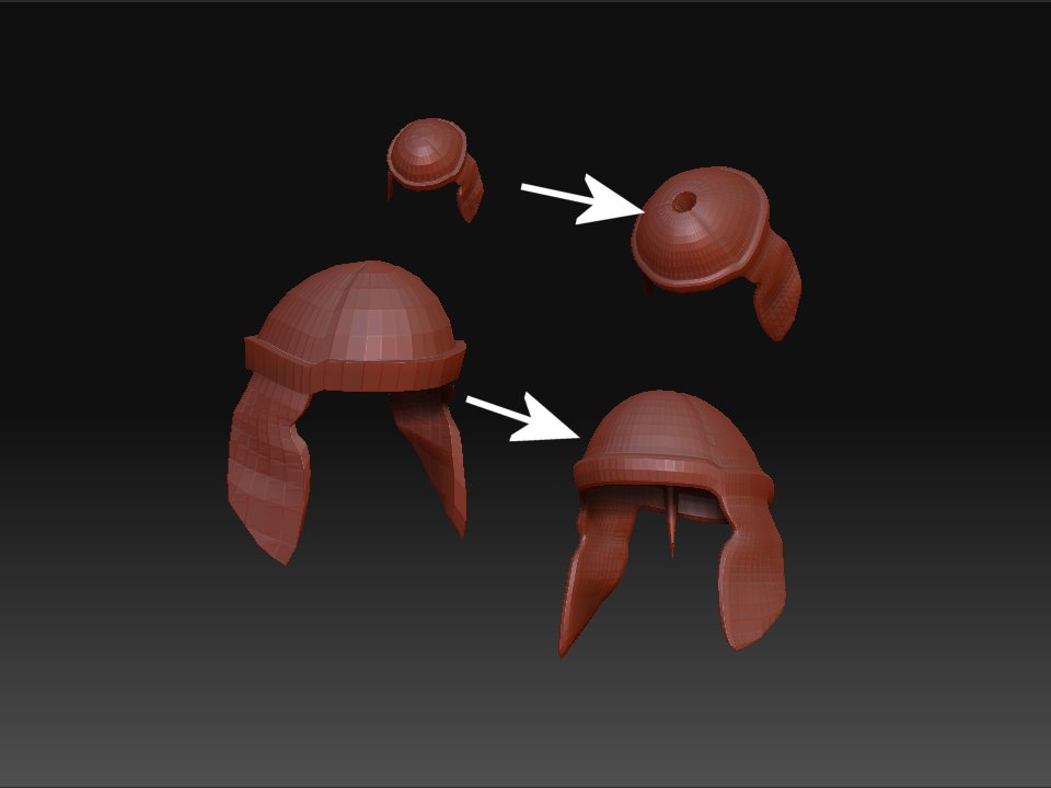

Had the same problem with a very small object.
To fix that, i had to smooth once this model once, before importing in Zb
