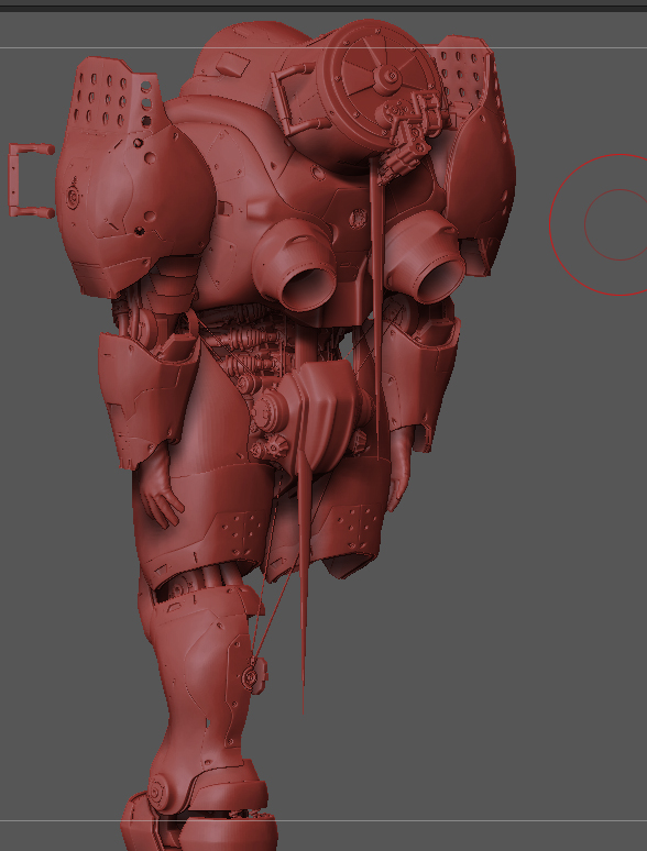

Hey guys,
I keep getting this error when i subdivide my model in zbrush, it pulls some vertices in weird direction.
Anyone knows what is causing it ?

you get weird stuff like that when the model gets bigger than the (Undocumented scene size)
I say that because at one point Big model= bad news
to size your model back down to the (undocumented usable scene size)
go to the tool pallet and then deformation and hit the unify button.
If all of those pieces are subtools I would suggest joining them first using subtool master and then unifying the model. you can then
Tool/polygroup/auto
Tool/subtool/grpspit them back to subtools
hope that helps
Hey dude,
I tried what you said, didnt work.
The model is one mesh. I’ve exported it from xsi to zbrush.
