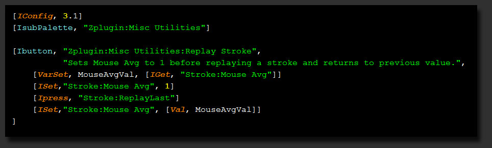

In any case I wrote a small script to handle the Mouse Average Input Count issue. You can find the script attached below here.
As always, extract the file into your ZBrush3/ZStartup/Zplugs folder. The button can be found in the ZPlugin > Misc Utilities subpalette, where it is named Replay Stroke.
Hope you find it useful.
As with all script buttons there is an annoying issue when assigning a hotkey involving the modifier keys (ALT, CTRL, SHIFT). You need to release the modifier key before you can use it again with that hotkey. Just something to be aware of if you use the same hotkey as the old ReplayLast button.
Assigning modifier hotkeys to the standard ZBrush interface items works just fine.
For anyone interested in the code for something like this, have a look here.
[[attach=155083]MOS_ReplayLast.jpg[/attach]](javascript:zb_insimg(‘155083’,‘MOS_ReplayLast.jpg’,1,0))

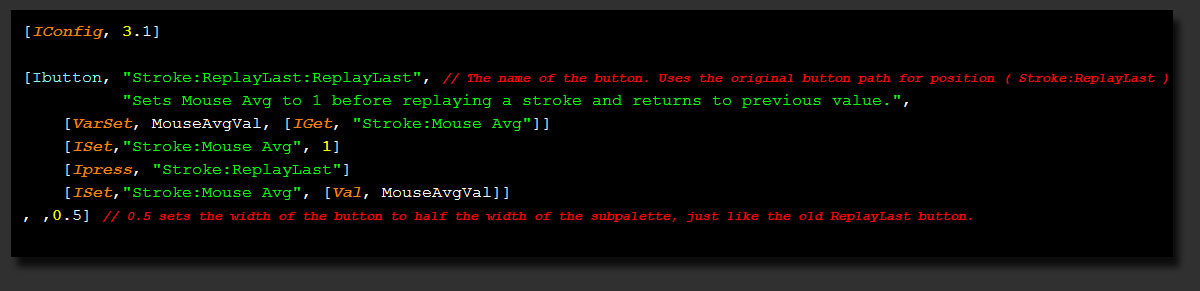

awesome thanks so much. is there a way to place the button in the stroke palette?
You can put it where you want. The script below puts the button on top of the previous ReplayLast button, as you can see from the code. If you put the button inside a subpalette then it is best to include a [ISubPalette,…] command like in the code above.
The button does not inherit the hotkey from the button below, so you need to assign it yourself.
[attach=155092]MOS_ReplayLast2.jpg[/attach]
thank you, i didn’t know it was possible to put a button over another, so is the old button actually underneath or does this replace it? just curious.
i will try this scripting method to add the render button into the light palette
The original ReplayLast button still exists. It is just that the button generated by the script covers it. So the old hotkey (CTLR + 1) will still activate the original button and other scripts will still use the original button.
If you prefer to have the button at the bottom of the Stroke palette simply change the IButton path name to something like “Stroke:SpaceBoyReplay” :wink: You might also want to increase the width by changing the 0.5 to 1 (the full width of the palette)
