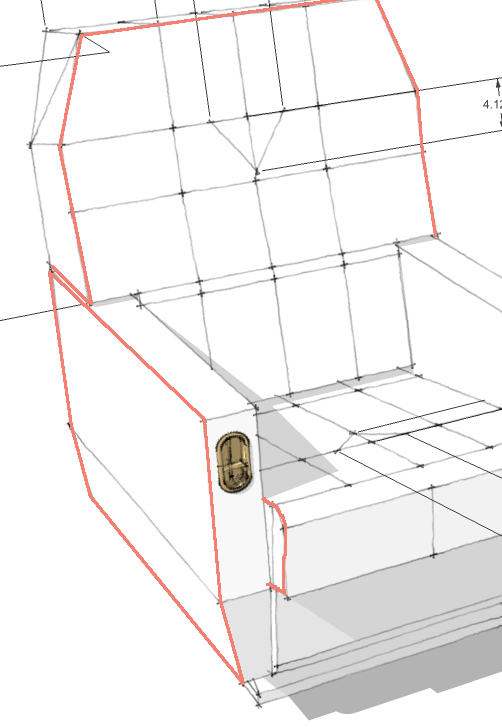

Thanks so much! Now that I read your response, I realize I did a very poor job explaining what I need.
I made a stitch brush that looks like a french seam. That is what I need to run around the chair arm and seat cushions.

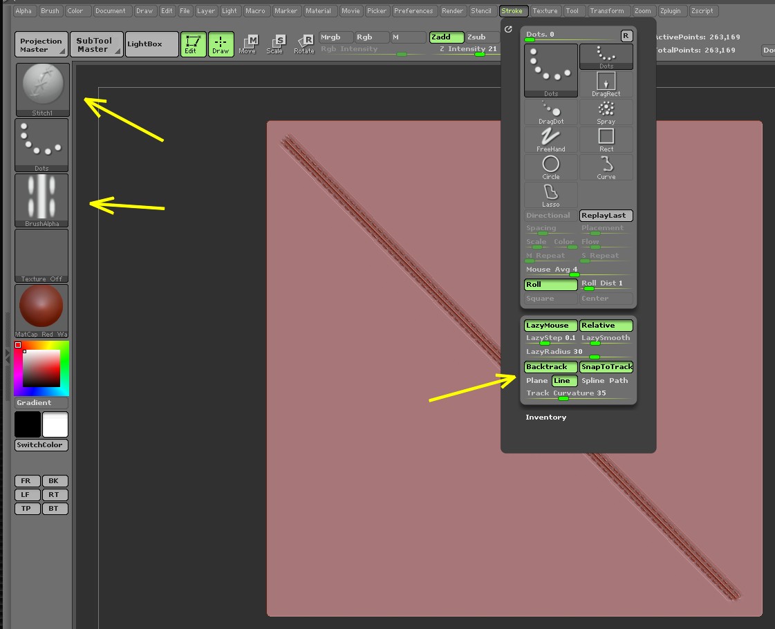

Try this and see if it works for you. See picture.
That is exactly what I need but It need to make a nice line all the way around a 3D mesh where the re is on this sketch.
