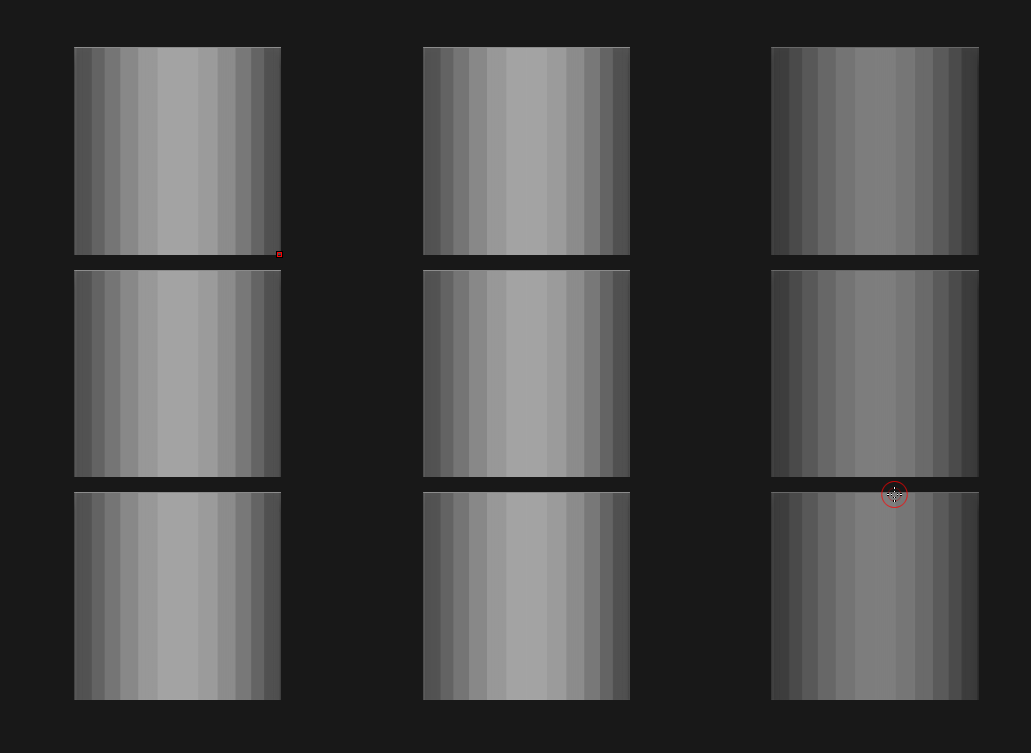

What I want to do:
For a script I am currently working on I want to add/or subtract Subtools from a list.
If it is not yet part of the list, add it - otherwise remove it.
Currently I do this by:
-[StrFind] if the currently selected Subtool is part of the list
If not:
-[StrMerge] padded with a few special characters to prevent mixups, to the list
If already present:
-Exclude by splitting the list in two (before and after the entry) and [StrMerge] the two pieces back together again.
Adding and removing this way actually works pretty well!
