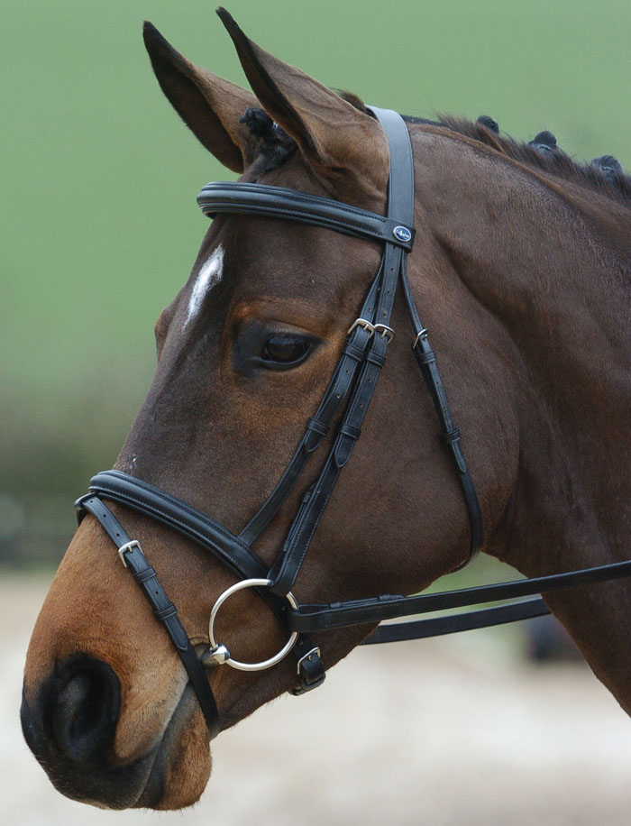

I’m always struggling with making straps and similar stuff. Right now, i’m about to start modeling a horse bridle which is pretty much nothing more, so i thought i’d check with you, good people of ZbrushCentral, about your workflows for such cases. Neat topology is a great bonus, but not necessary as long as the workflow is efficient. I’m about to model smthing like this:
With wider bigger straps I’d just play with topology tool, but with thinner ones, they come out too distorted and cleaning takes a while.

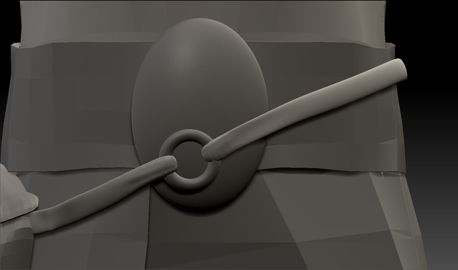

Knedlo, I was experimenting a little today with a way to make straps and found that using the ring3d tool with a low inside radius works pretty well. Better for me than using zspheres. Initialize the ring to get the most basic shape, make it a 3d object and then you can use the deformation pallet and the move brush on a large setting to refine the strap however you like.
Here’s what I’m working on. It’s obviously not real refined yet, but the basics for a decent looking strap (totally separate geometry) are there.
Hey… sorry it took me that long, but I was busy working. So again thanks for the tip… This can be pretty usefull in some cases. :+1:
