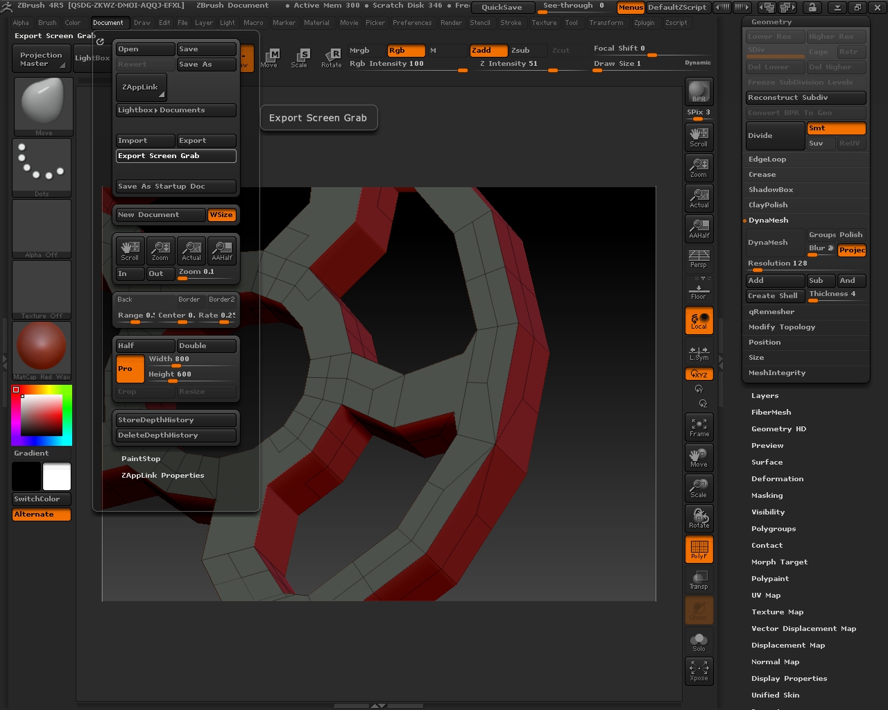

Can anybody tell me whats wrong with my model that I created from a Circle3d Morph Diff?
And how do I get a screengrab without the document menue open?
first off…what is a circle3D morph diff?
secondly, just dock the window to a tool bar and hit the button…or you can assign a hotkey to the function and hit that.
I created a lowpoly base from a Circle3D and I used Morph Target create diff to get some volume.
instead of using a morph target difference to generate the depth you could use the action line, or just do a simple extract to give it depth. See if one of those give you a better result that what you’re currently getting.
Ok thanks, extract works fine, but how can I use the transpose line to get depth? Extrude works only combined with masking.
In the geometry pallet are some scale and location sliders.
Are you using the Axis panel thingy? http://www.zbrushcentral.com/showthread.php?161588
You mean in the deformation pallet right? Well I think the problem is that the Circle3d is flat geometry and you can not get volume with the size slider.
Not the deformation pallet. Towards the bottom of the Geometry pallet.
modify geometry inside of geometry, I think.
You mean the new size slider in the geometry palette? That does not make any difference it´s still flat geometry. I think the only way it works is with extract.
