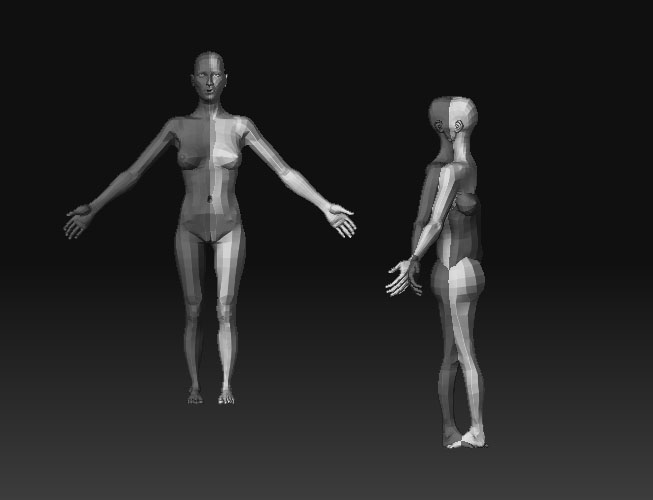

When I try to resym the mesh I have been working on, I get this rather strange error. The mesh folds on itselft at the seam. This mesh has given me issues with the x mirror symmetry but that was solved using the possable symmetry.
The mesh was imported from an external program.

I created it by using a X mirror modifier in blender, so both sides were symmetric coming in. The x mirror modifer in zbrush without using the possable symmetry correction, was off center (the icons were red than). With the poseable symmetry correction it became green and correct.
I mean that the mesh wasn’t symmetrical to begin with. I’m sure it was built symmetrical, but something along the way – probably an export setting – caused it to lose the symmetry. That’s why the poseable symmetry got you going again. But poseable symmetry doesn’t apply to deformations.
So what do you suggest I do, to at least retain most of the details from the sculpt? So that I can resym it nicely in the future?

The resym make her eyes pop out, and she still inverts on herself with a resym.

I sent to both of you the file. The file is UV mapped as well, which hopefully isn’t causing the problem.
okay this is really simple, your model is on the wrong axis, if you look in the tool: preview window you will see your model is sideways, you want it facing forward. to do this you need to

the problem i think you were running into is that your model was symetrical along the Z axis but you were using Resym on the X axis.

Resymming on the Z axis fixed everything.
