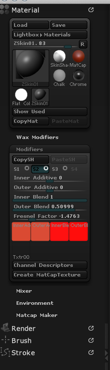

For the DemoSoldier project above, look at the way the material is constructed. The SSS blend colors are in the second Shader - click S2 in the material Modifiers.

I just downloaded Marcus’ file and opened it. Go to Material > Modifiers. S2 is right there:
Once you’ve tweaked it, you can save the material to use it anytime you want.
