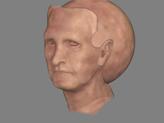

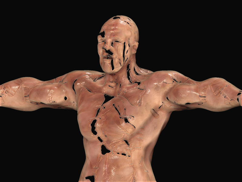

Need Jantim’s help on this I’m sure. Got this skin material (made it wet looking on purpose) but I can’t remember how I got the decay type cavities in it. Want to get rid of them because if you got rid of the blemishes on this material and crank up the Metalicity to 100 on S4 to get rid of some of the built in specularity, it looks like real skin. Im getting close guys, if anyone wants to help get this done I’ll upload the material. Here’s a sample…
Yeah, that blotchiness really makes the difference! I’ve grabbed several skin materials off the forum, but none have really been close to loooking like skin to me. This looks like the best so far. A bit to shiny as it is, but the colouring is very good indeed

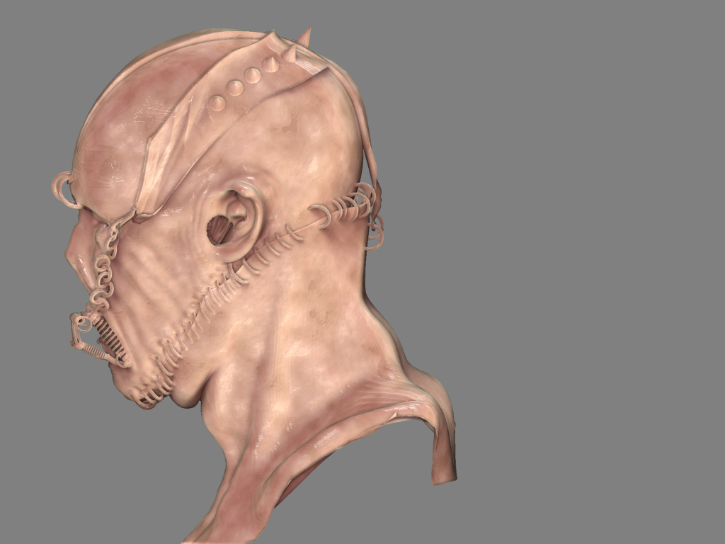

The wet skin and the normal skin with Mahlikus the Black lighting works the best. Try it out on any hand models or body models. Even heads look pretty good. Let me know what you all think of this. It is my attempt at a fake SSS material for skin in Zbrush. Thanks to Mahlikus the Black for the light. The material started as a maggot material for a sculpt I was working on and then I started tweaking and got to this.
I think I will try this out on my anatomy study!
It does look really cool though, sickly. You might want to add tiny little blue veins and a bumps based on orange skins. Although for your character you could use anything really to make a crazy skin texture!

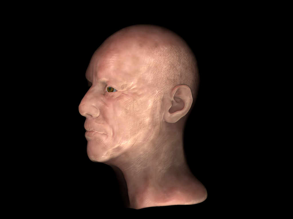

This is a completely untextured model. I used only the skin material and a light that is set up like a spot light shining in the dark. Still waiting on Jantim to look at this and possibl tweak whatever he sees fit. Any suggestions?
I did a few test renders with this myself. It doesn’t look quite right, but your definitely onto something with this, Jigsaw
Shadows don’t seem to cast very naturally with this as it is, also light seems to be unaturally intense in places that probably should be in shadow, but the skin colouring looks really nice, if just a little harsh. It gives characters a sickly diseased look, great for zombies I’m sure
Hope someone can tweak this to perfection, cos Jigsaw has done some really solid groundwork, and this could end up being the perfect skin material

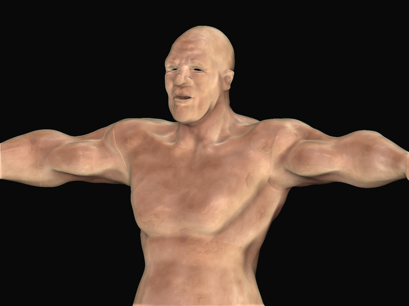

had a quick play and came up with this, any good?
Hephisto here looking pretty sporty in his new duds.
Helps if you use a color texture with the material.
Great material man. Very adaptive. I would have to say one of the best I have seen so far.
For a non zombie look you could use a light skin as the underlaying texture;)
one bad thing this material will show EVERY flaw in the model!

cant figure where the rust like bumps are coming from

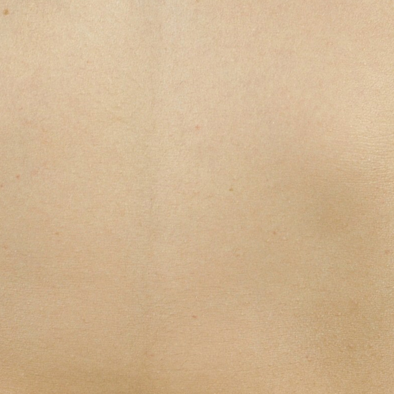

For the color I´d use a texture, use the material only for effects like sss, specularity and these things. Even bump is better controled by a map.
so try to use as a base color for the material a simple touch of orange and add a texture, probably this will bring you to better results.
