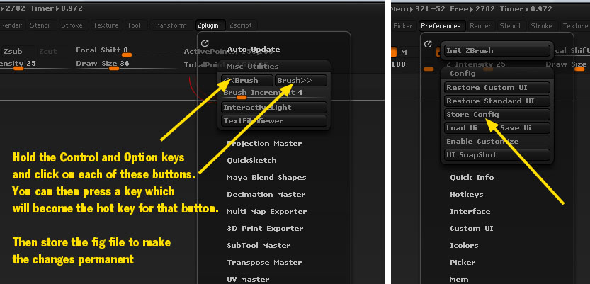

Since there have been no answers to this does that mean that the square brackets are working for every one else? They don’t work for me at home or at the office. I am guessing that this is a 4R2b problem.
-Joe

I run a Mac and sometimes I accidently hit a weird keyboard shortcut that changes my international settings from USA to Canadain French and this doesn’t allow me to use the [ ] for brush size. I don’t know if this will help?
I put in a support ticket on this. It seems to me that unless there is some control that I don’t know about that turns this feature off then it must be a bug.
I have the same problem. Also running on Mac.
I’m having this same issue- I tried pasting
[ZPLUGIN:MISC UTILITIES :<<BRUSH,91] // [
[ZPLUGIN:MISC UTILITIES :BRUSH>>,93] // ]
into my startuphotkeys.txt as someone recommended and that didn’t work. When I ctrl+alt on the focal shift or draw size slider it just changes the hot key from S and O all I want to do is size my brush up and down like photoshop. The weird thing is I have this same version at work and the brackets work fine!
The only difference is I have a 24HD cintiq at home…could that be the problem, a conflict with the cintiq?
I found the answer to this in another thread which I don’t seem to be able to find now. The attached image shows how to assign hot keys to the bracket keys.
-Joe
