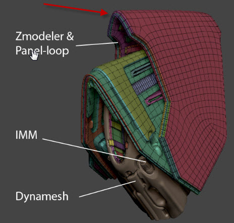

Could you explain a little bit detailed how do you apply panel loop to get that kind of effect that you have in the 4th W.A.S.P tutorial picture “Zmodeler & Panel-loop”? This is the effect I’m trying to figure out how to make it :slight_smile:

3dsmax: im not sure what you are asking… could you give me the timeline on youtube or juts more clarifications?
Marco: I’m referring to this part:zbrush.jpg
After you use Panel loop, the thickness is free for you to create insets in it or whatever you want. I typically use the ZModeler’s Edges-Insert and the Polygon-Qmesh-Polyloop. Once you have done this, use Group-by-Normal with the appropriate angle value to assign Polygroups to isolate where you want hard edges (considering you can add Creases where 2 Polygroups are not the same color).

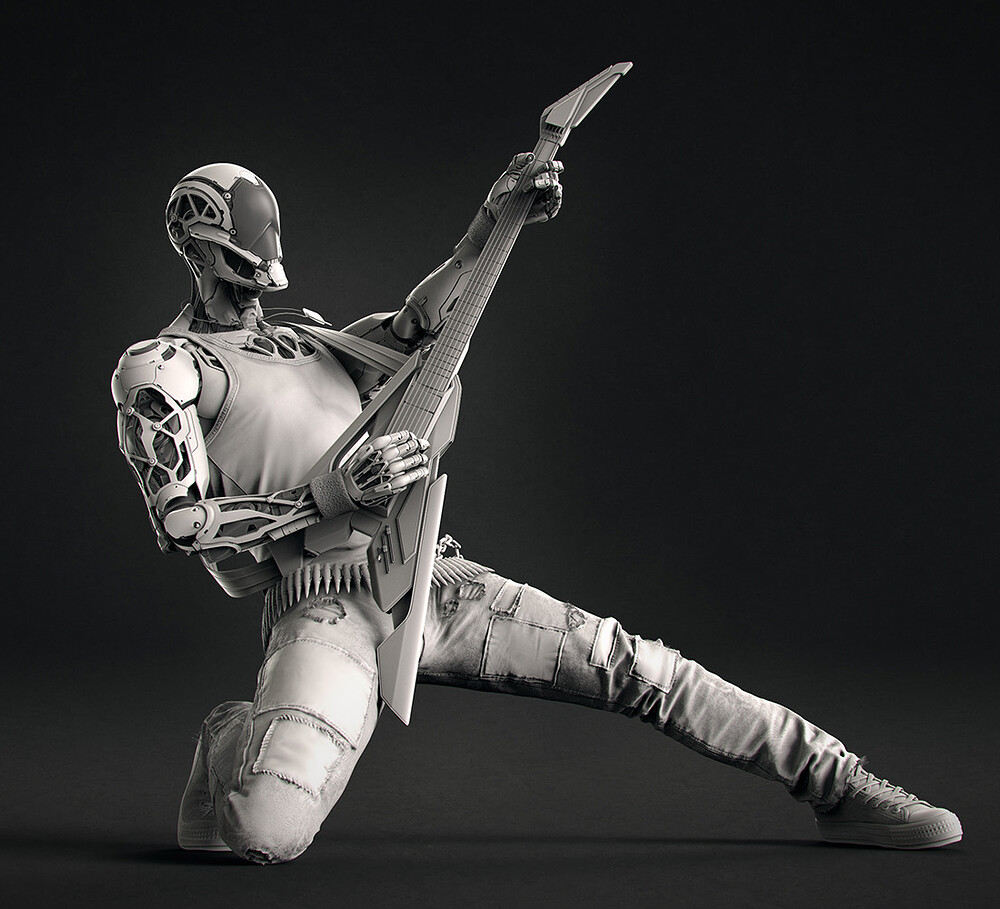

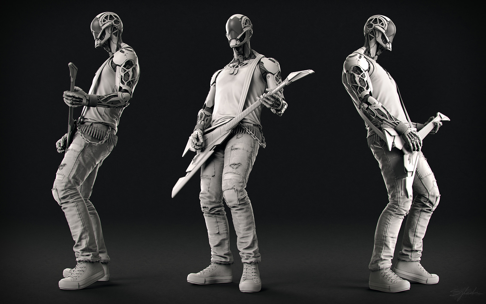

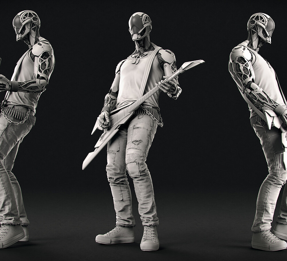

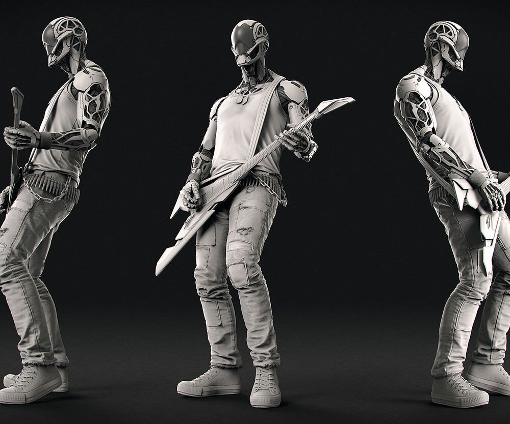

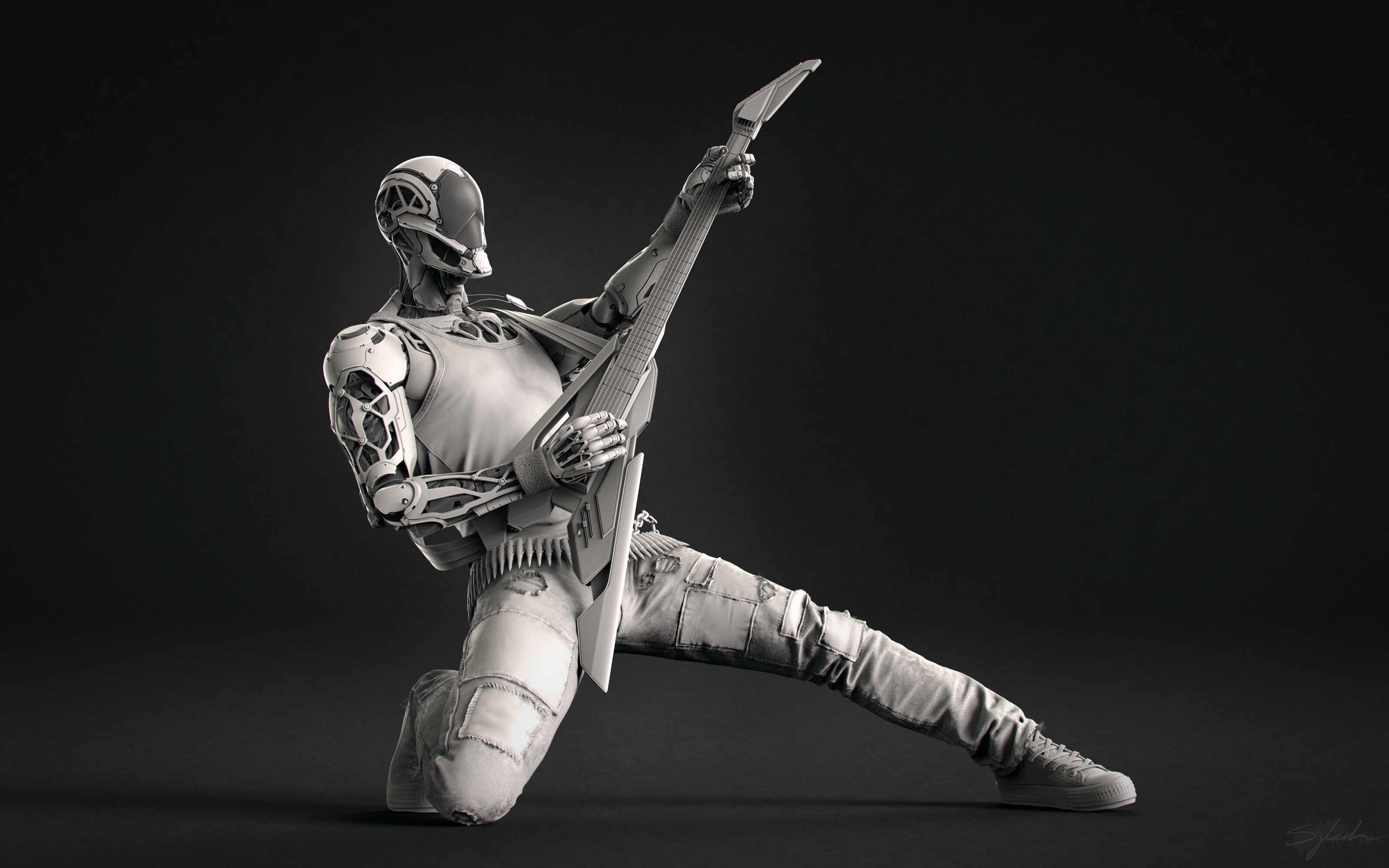

Here’s the finished version of the model I showed real quick at the Zbrush Summit during the Keos Masons presentation. The idea was to represent how sentient robots of the future will still celebrate the 80’s Metal culture. My idea came from the quote “The Metal will live on” from a Tenacious D song.
Turntable:
http://www.marcoplouffe.com/rockerbotturn.html
Highres versions:
Wowaa! Another masterpiece of art Marco! What’s that script you are using to create turntable from jpg sequence?
Hey thanks!
It’s a Java script that scrolls between 90 rendered images. Here is more info on how to set it up:
http://www.polycount.com/forum/showpost.php?p=1964191&postcount=126
great thanks for the link!
So much awesome in here! thanks for sharing the breakdown! that knowledge will come in very useful I’m sure!
thanks a lot and no problem :slight_smile:
This is cool on so many levels. Nice job!
great model. damn fine execution. is it all zbrush? (sorry if you already answered that)…

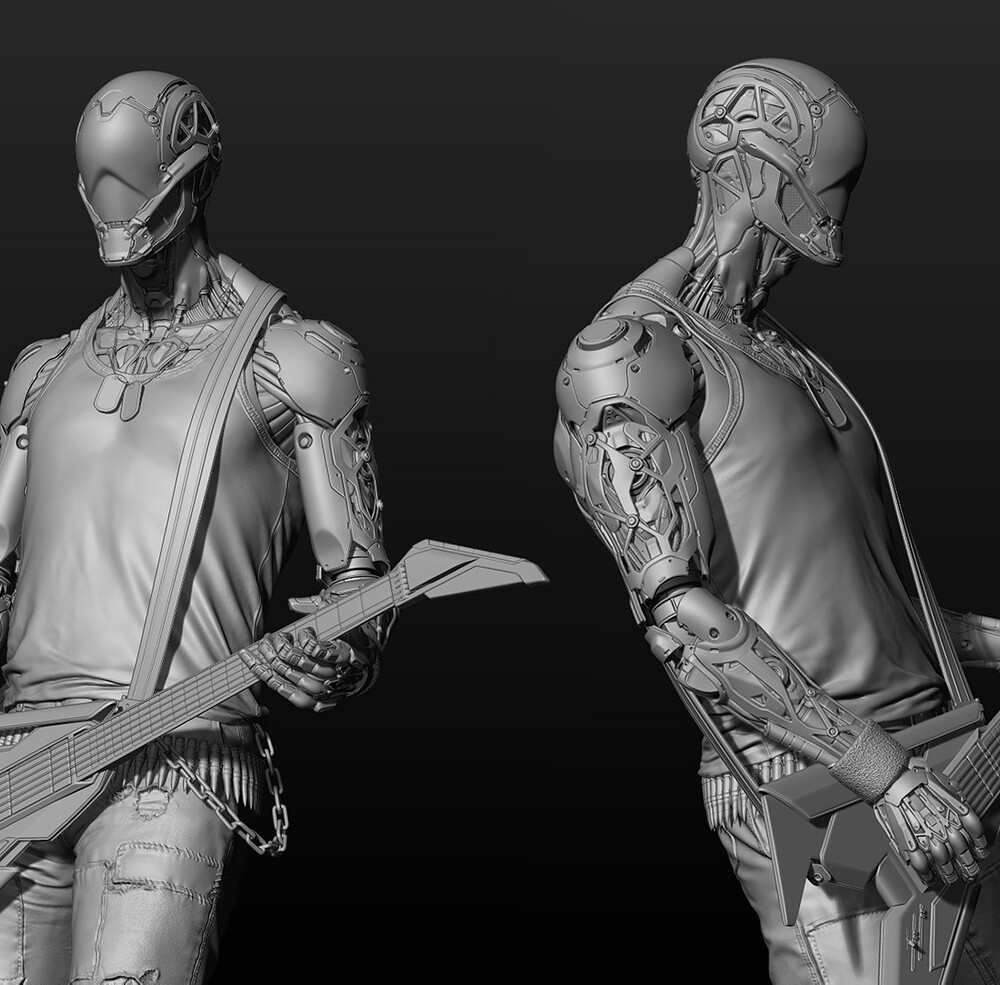

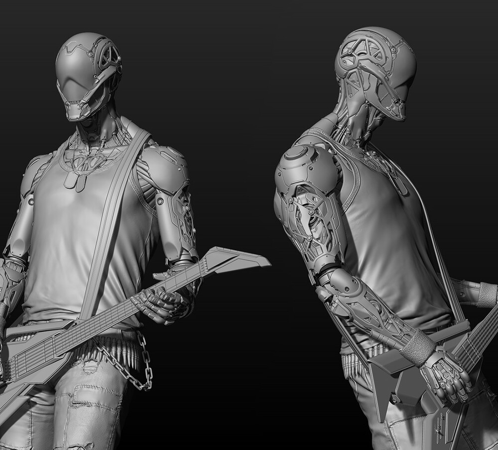

At popular demand, here is a closer look at the torso part.
Top row! Oooooooh top row!
!!!Stunning work!!!
