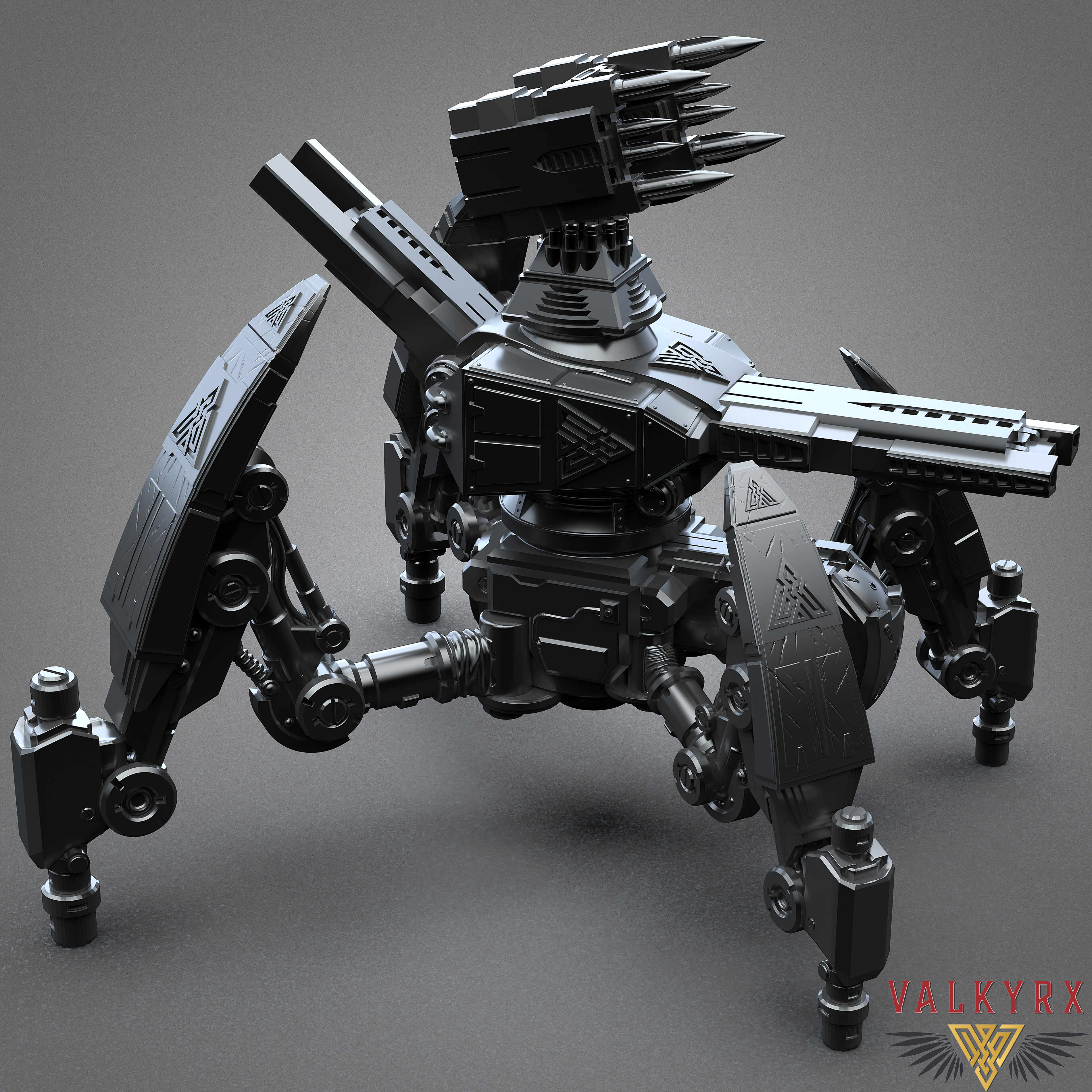

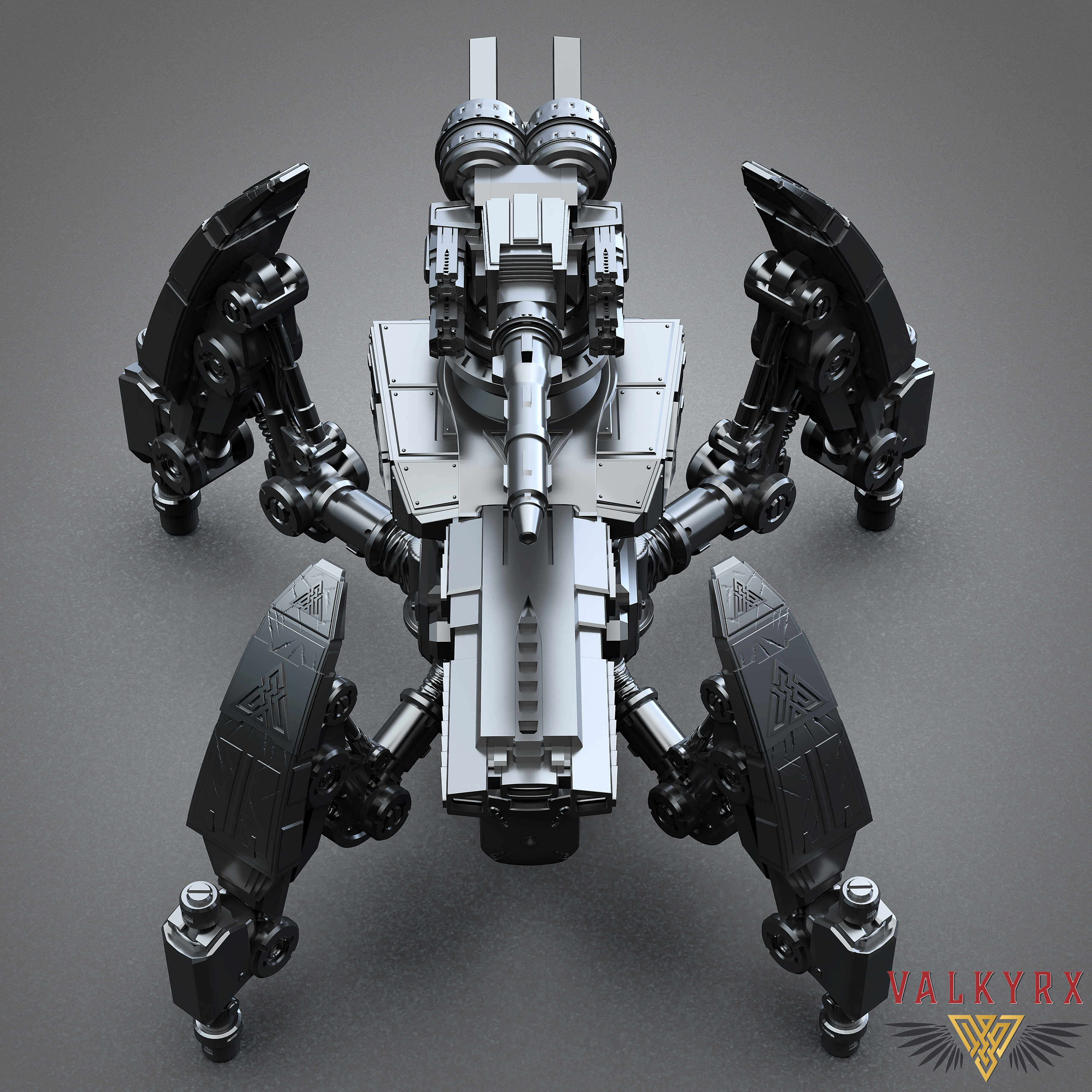

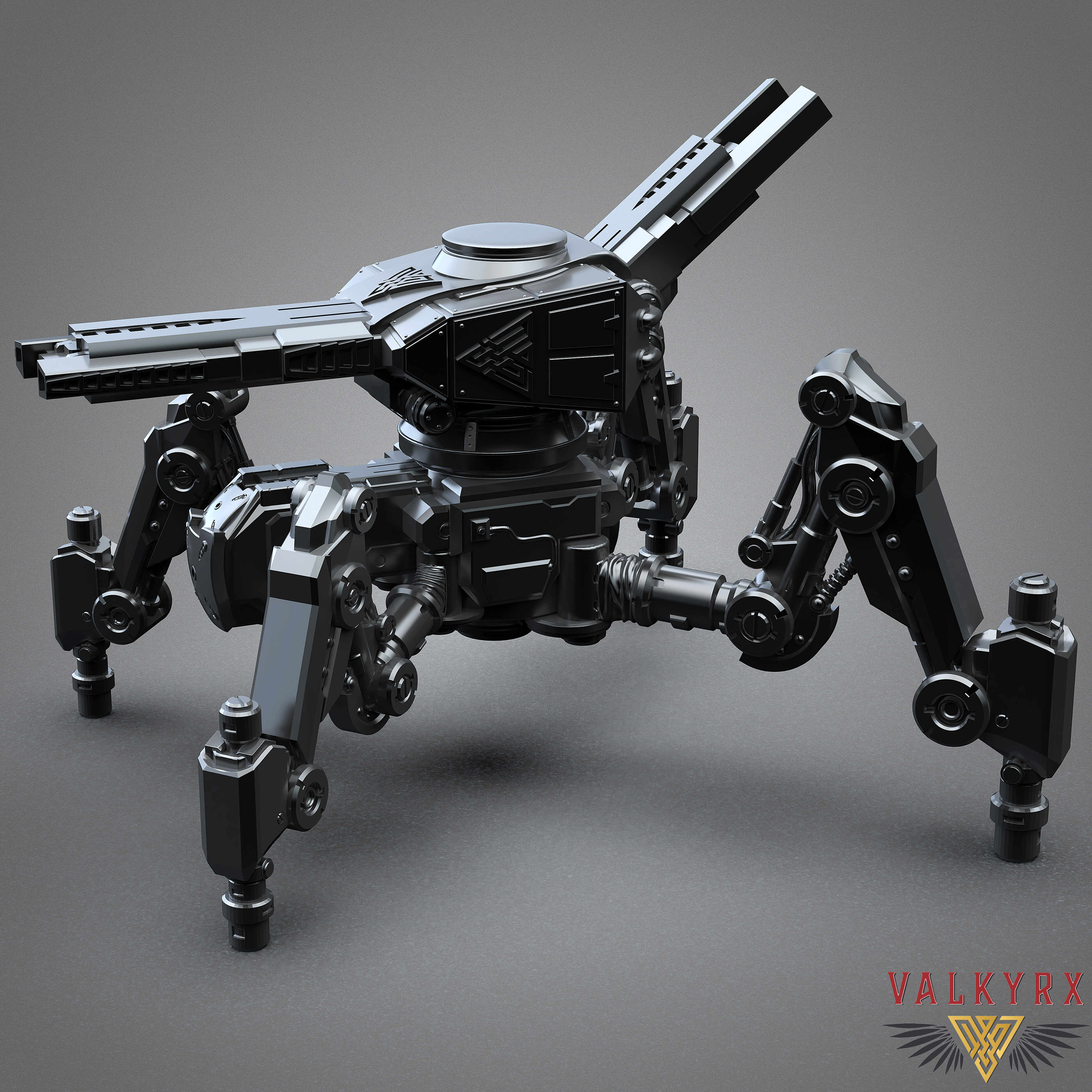

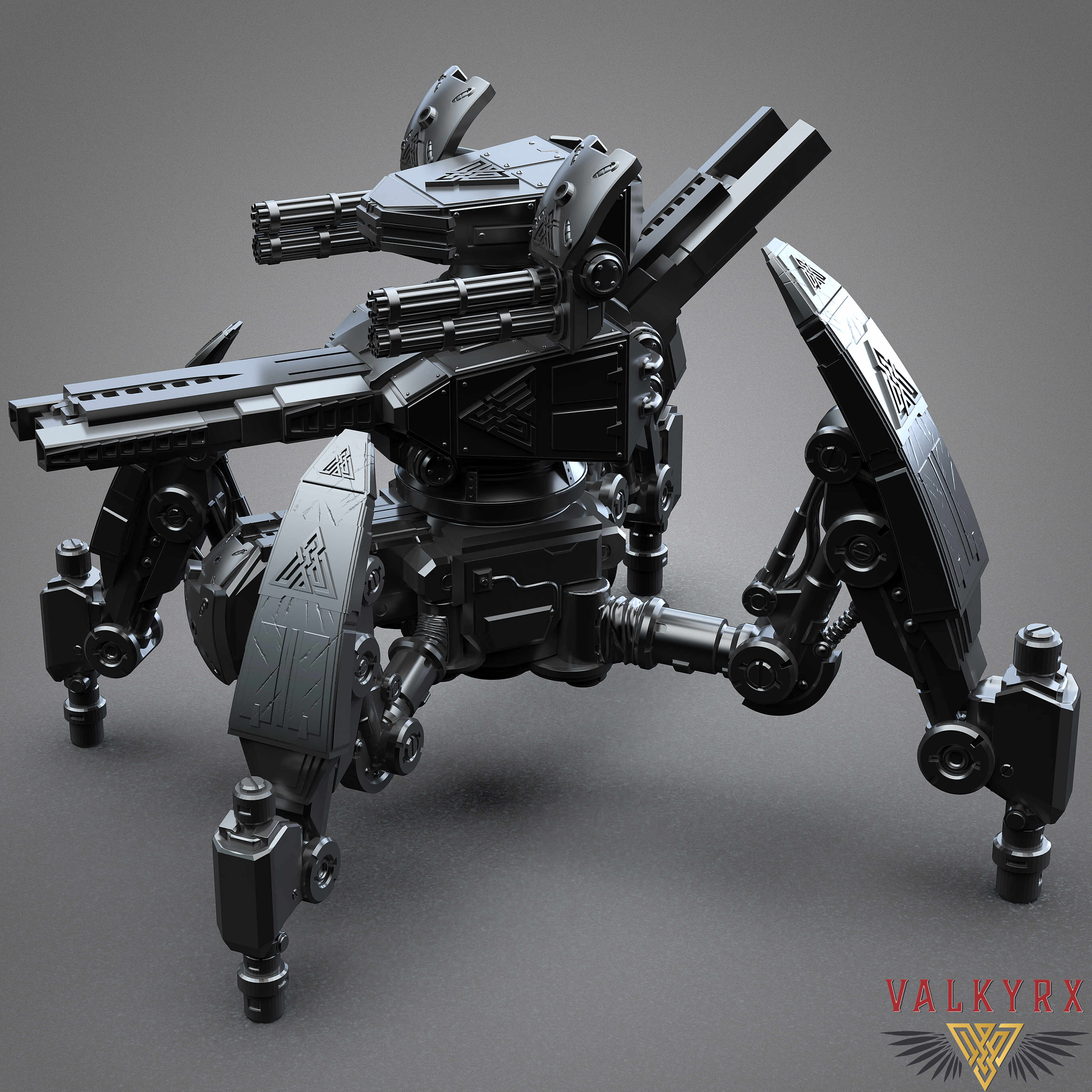

Hi everyone!
Thought to share some spider robots I’ve worked on recently!
The main idea behind this miniature was to create a highly customizable support unit in the battlefield that can move and attack in different ways using extra turrets: minigun, flamer, laser and missile.
Multiple permutations of the model are also possible due to the extra armour panels that can be easily removed or added in order to have a more agile unit or a tank depending on the needs.
Hope you’ll like it!!
Nice! What ZBrush features did you use? Would love to see more information
Thank you @Jaime !! Glad you like it!!
I’ve been using mainly Zmodeller , together with booleans, dynamesh, creases and clip brushes depending on the parts.
Sometimes what I like to do to get certain shapes is also:
use the slicing on a simple plane, get the overall silhouette I need for a certain part
Hide and then delete hidden the sliced sections I don’t need for a specific profile of a new subtool
Zremesh with a relatively high resolution, turning on keep groups if needed with curve strenght to 0. I’ve also noticed that decreasing the topology gradually with Zremesh using the “same”, “half” functions helps to gradually obtain a better mesh if needed (I might have seen that from one of Mike Pavlovich streams)
After that I use Zmodeller afterwards if I need to give it thickness or change the overall details.
Also I’ve been using quite a lot the extruding edges and faces functions in the Zmodeller menu, those are really awesome!!
I still need to give a try to Snapshot 3D for sure at some point, I’ve seen the potential of that function with some past presentations, especially the way Cki Vang works with is incredible!!!
Thanks for checking this out btw! Cheers!!

Looks vicious , great modeling ! How tall is the miniature going to be when printed ?
Thank you!! Most likely it’s going to be around 80 to 100mm in diameter, so quite a large piece. I’ve splitted the piece in 10 or 11 parts if I’m not mistaken, plus the extra turrets on top!
As soon as I have some resin prints I’ll do my best to post the final results here!
