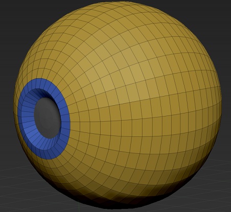

is it possible to add a newly created polygon group or newly selected mask to an existing group? I mean in a simple model like sphere it’s easy to select everything and grouping it again but what do in a complex model?
is there more option for selection rectangle? like in max and where you can switch between whether polygons should completely come inside rectangle or part of to make that selection happen
in this particular case there are two concentric circular set of blue polygons one gone inside and another one matching with the edges of yellow polygon group now what should I do if I want that set of polygons in edge to be added to yellow polygon group?If i turn view to side and try to select booth, the one inside also gets selected, so only work around I figured out was hiding the yellow group,selecting the outer rim in side view of blue group making it new group and then hiding the blue group selecting everything and making a new group is there any other workarounds?

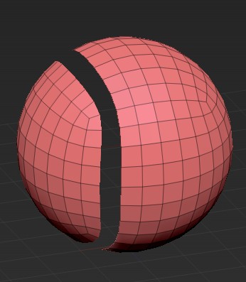

is there any other way of selecting polygons? like selking every individual one. or a loop like in max graphite tool etc
when the selection tool switch to “lasso”,you can then click on the edge for hiding “ring edge loop” like this:
also in the visibililty panel, you can click grow or shrink:
Wow! namdoyle that’s a very handy trick, thank you so much :slight_smile:
