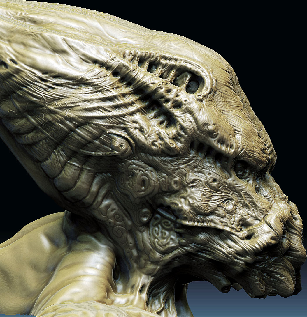

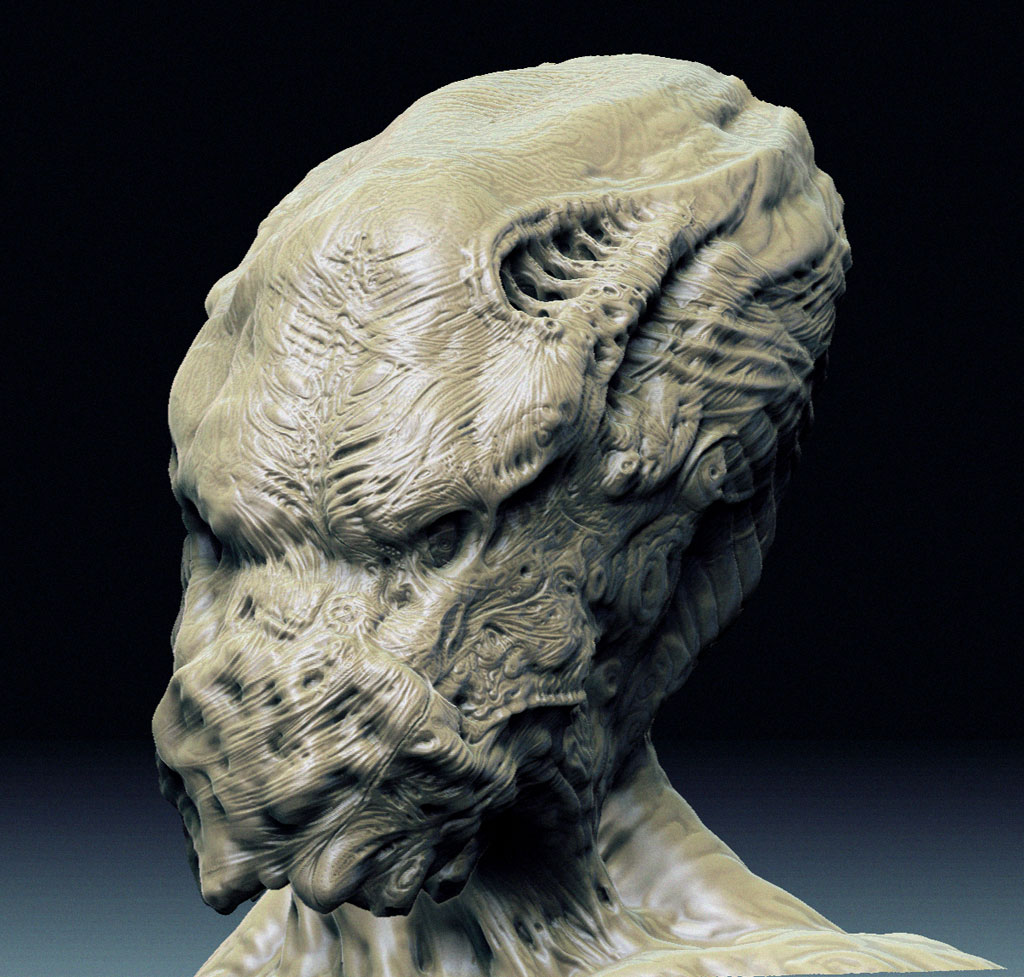

Since I really have no time for making videos these days I decided to prepare a quick bunch of examples of how I make those details and very thin skin wrinkles.
The thing I doodled doesn’t have any sense creature wise. I took a 3D sphere and started to play with it trying to make it look organic. It may look like something alien but really has totally no sense :slight_smile:
Basically the idea is to try and show the masses and structure underneath the skin sculpting very thin flops of skin that overlap where’s the mass and stretch when the mass (can be muscle or anything) goes down so that it looks very organic.
You can see it on the first image while the second one (that’s actually the profile view of the first) has different kind of shapes.
It’s actually easy to make this kind of effect, just need some practice. My advice is to use real clay to understand this perfectly.
Gotta run now for a while.
Hope this will help somehow :slight_smile:

thanks it helps now i know what u mean by small snakes
