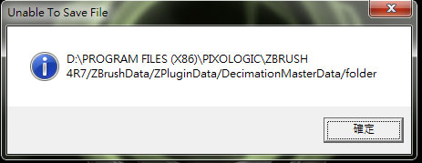

Hi,
I’m using 4R7.
the problem is the “pre-process Current” and “pre-process All” of decimation master do not start.
it show up this message when press “decimate Current” or “Decimate All”
please help!
Hi,
I’m using 4R7.
please help!

i don’t know it’s whether related problem:
it’s missing Plug-in folders after i installed 4r7
this kind of message appear for each Plug-ins.
but, i created these folder to fix it.
it’s normal in 4r7?

It looks like it’s installing the shared data in the wrong folder (which has limited permissions)

It looks like 4R7 is set to putting your ZBrushData folder in the C:\Program Files (x86)\ZBrush 4R7\ and that directory is probably set to Read Only. This is why you can’t run Decimation Master. It has to be able to write a file to that location but its permission is denied as it’s set to Read Only.
4R6 is probably using the correct ZBrushData location (which by default should be Documents\ZBrushData) and that folder has write permission.
I’ll bet if you did a file/folder search for ZBrushData you’ll find two different locations. You also might be changing the directory location of the ZbrushData folder during the install. Try uninstalling 4R7 (but keep 4R6) and then re-install, but make sure you run the installer with ‘Run as Administrator’. Also don’t just click okay on everything but see where the actual install directories are being setup during the install process. You probably changed these from the default and so it’s running into permission issues in the ProgramFiles directory.

Thanks MentalFrog, your direction is right.
Finally I solve the problem.
The fact is 4r6 and 4r7 want to save files to :
C:\Users\Public\Documents\
“Documents” should be a folder,
I don’t know why,
“Documents” in my system is just a file without any file extension.
This make 4r6 and 4r7 cannot create the file to here, but
4r6 can run fine without this location’s files.
4r7 cannot.
