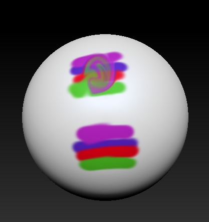

I have a high poly model Im painting, but Im really struggling to get the smooth tool to actually do any smoothing of paint.
on the first pass it does blurr things a little, but after that it just seems to do nothing at all.
anyone any ideas how I might be able to control how much smudging takes place or if there is a tool Im missing?

If you use projection master you can use the 2.5D smudge brush. It can appear to create depth, but when you pick it up it is a flat smudging of color.

Use your Smooth brush (Shift key) but do your smoothing on lower subdivision levels.
edit: with ‘Rgb’ on only. Zadd or Zsub off.
Im already using the lowest sub division level, I had to delete some of the far smaller ones in order to complete other tasks during creation.
I have been using the smooth tool, but like I said above it only blends paint on the first pass, after that its ineffectual,
I have Zadd turned off, its poly count of 855k so not massive…

Ok here’s another way…although you still have some extra steps.
Paint your model and grab doc from the texture palette. Don’t move anything to make it easy to reposition the spotlight image. Turn on spotlight, position the grabdoc to the size of the document screen and it will line up quickly. Use the spolight smudge brush on the spotlight grabdoc image and then repaint it back down onto the model.
